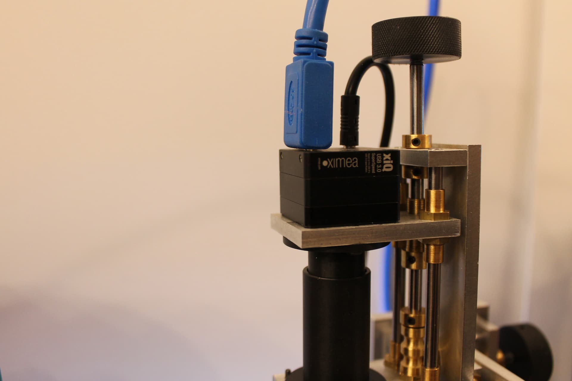

Ventura Images is a low-end scanner, and for €10K it is very expensive to spend for what you get. For what they’re charging, honestly you’d be better off looking at Film-Digital. The camera in the Ventura Images scanner is xiQ so the 2K camera is CMOSIS:
That camera is not suited for scanning. Neither the 1.3 MP models nor the 2K models, even MovieStuff had a higher spec camera than that one. Changing the camera for a better one would revert it back to being a DIY scanner as their capture software would only support the hardware as it comes to you. There’s lots of other parts that are under-the-hood so to speak as well, and that also affects the quality of what you get. The track that the camera is mounted on looks decent. Given the number of controls on the front of the machine, I’d say the capture software it comes with will be extremely bare-bones/basic.
I’d have to see examples of the work off one to know more about the limitations of its light, optics and gate design. With 8mm you will have a lot of really dense film that’s harder to capture well when compared with the average stuff that post-production houses traditionally scanned. The quality of the backlight makes a huge difference, given the cameras they’re using I do not think they’ve built a light that comes close to the quality of the one that Filmfabriek uses (their one is custom-built it’s not a retail LED mounted on a heat-sink).
