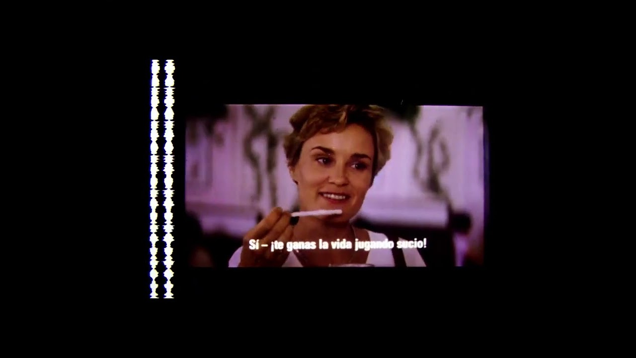

Hello. I always extract 16mm optical sound and it always comes out very well. Now I’m trying with 35mm and the sound comes out weird, like it’s slipping. I leave an example. Does anyone have any idea if I’m doing something wrong? Thank you
example 1
example 2
It sounds like you don’t have enough overlap between the previous and next frames for it to make continuous audio.
Is the image in the video exactly what you used in AEO Light? It looks like the soundtrack is slightly cropped and the film is rather unsteady. Both of those things will affect the sound extraction.
