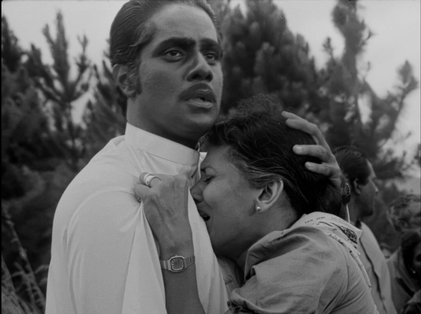

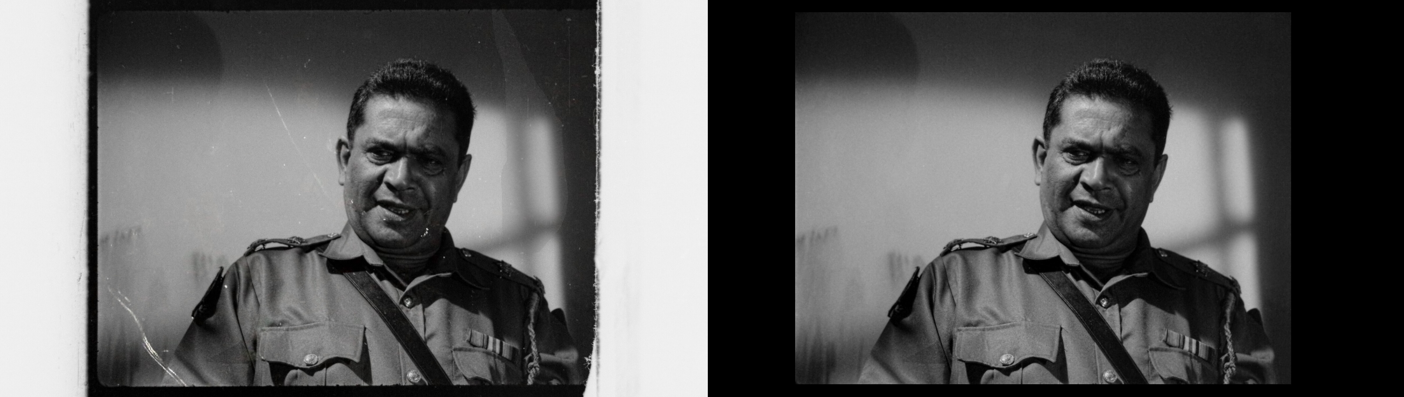

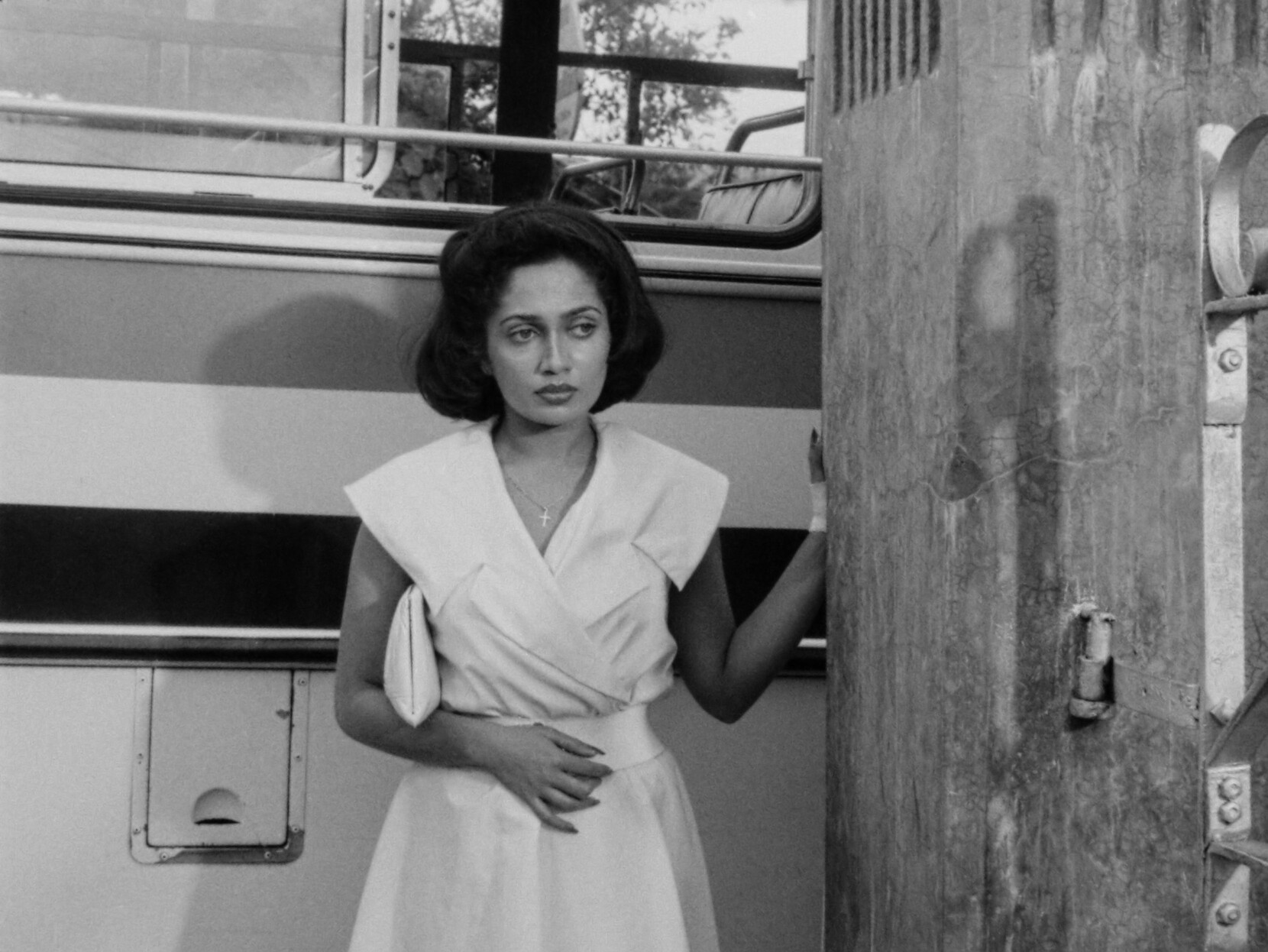

I have used a diffusion screen cut from a backlight panel of a discarded LED television. I managed to get very good results as you can see from the following samples. They are from a 35 mm film.

This was scanned from the original negative and restored by us.
I do not know whether this material transmit more light than white diffusing glass. But the diffusion it provide is excellent.
