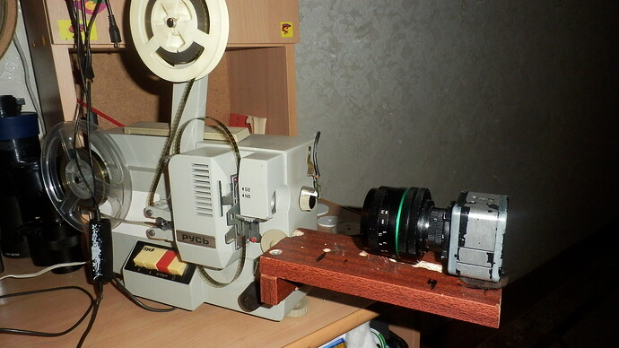

I use this camera from China for frame-by-frame scanning - https://aliexpress.ru/item/32913814498.html
lens - https://aliexpress.ru/item/32831833813.html
I scan 8mm and 35mm films. Resolution 2592x1944.

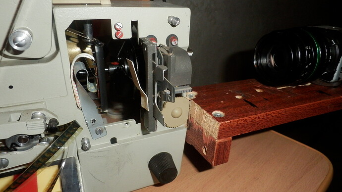

I’ve seen your 8mm example in youtube: marvelous!
Could you pls share a picture of your setup, especialy the film-Lens-camera area.

During a pause in the movie projector, the reed switch and magnet close the mouse button on the PC in the S-EYE capture software. I save frames in bmp format. I extract the AEO sound.
Excellent.Thanks. Must have a look at S Eye.
Another question. It seems that you were driving a projector with a separate motor. How did you coupled the motor to the projector?

Motor reducer window regulator from the car. Power supply with direct current 7-12 volts from a separate transformer.
