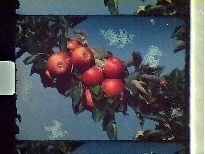

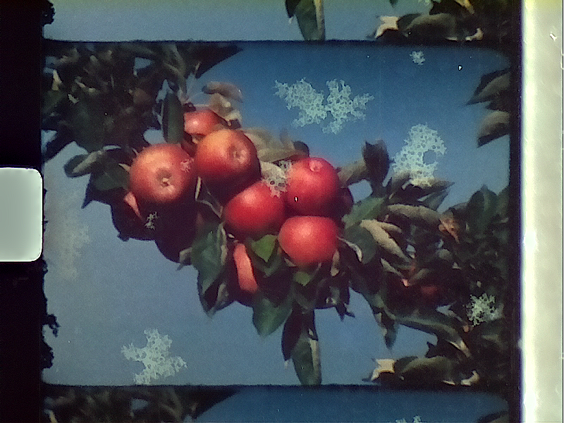

First, some parts of the movie have some fungous(?) patches. Here’s an example:
Most interestingly, other parts of the same reel are perfectly fine.
So here’s my question: Are there any ideas/approaches/suggestions how to clean film before scanning? What is your approach? Are you using post-processing to get rid of such stuff? I’d be interested to get some feedback from the community.

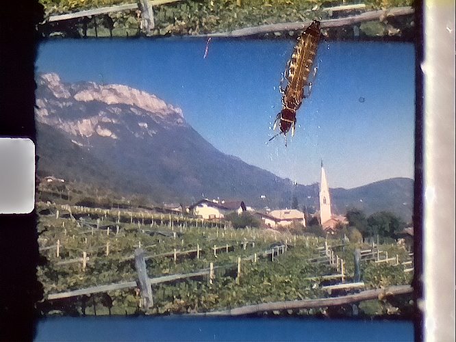

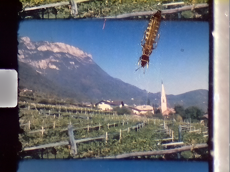

By the way, here’s another unexpected discovery from the same real:
That poor bug has probaly been sitting there for tens of years…
(I know how to clean this part of the film… :wink:
That bug is a keeper! Haha.
Those white blotches look like mold. Not much you can do there except to use film restoration software to eliminate those blotches in your digital scans. There is an app called Neat Video that can do some restoration, but I only use it for removing noise from images. (I’ve observed that its dustbusting tools can introduce artifacts into the film that didn’t exist before.)

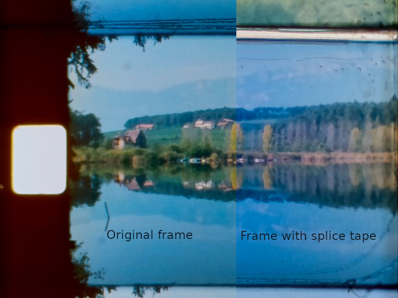

Well, the adhesive pads were for splicing parts of the Super-8 film together. A quite usual approach in the old days. Technically, I think they are called “Super 8 Splice Tabs” or “uper 8 Splice Tape”. I own an old Würker film splicer which can work with the standard size, covering 4 consecutive frames, as well as a special type which only is applied to one frame before the cut and one frame after the cut. There were also special variants which left the stereo soundtrack uncovered. You can still get them today from a few manufacturers.
Here’s a side-by-side comparision of the color shift I mentioned above:
On the right half you see the frame immediately after the cut. This one is covered by one of the splicing tabs. On the left half, the frame immediately following the tabbed region is shown. Clearly, the colors change monentarily for the frames covered with the splicing tab, obtaining some blue tint. Nothing serious which can’t be corrected in the post, but interesting.
Just a short update. Cleaning with 99% Isopropyl Alcohol and a soft tissue did help with a lot of the issues of the example film described above.
However, as predicted by ToddRuel, the mold parts were not at all reduced or changed by my cleaning efforts with Isopropyl. Here’s a new image of this film (already cleaned with Isopropyl)
which shows that this material has taken quite some beating over time. The clearly visible white patches are the mold.
After some additional internet research I actually found out the following: it seems that in the beginning of the 80’s, Agfa Moviechrome, Perutz and other material was coated with something derived from bee wax - which is ideal for mold to develop.
Well, it turns out that the solution is very simple: just use a cloth and destilled water to wipe off the mold. Gets off easily. Just make sure to dry the film after application of the destilled water. Here’s the same part of the movie after the destilled water/cloth treatment, followed by a Isopropyl/cloth cleaning step:
Clearly, the parts previously affected by the mold are gone. Here’s a comparision between the inital scan (left) and the result after cleaning (right)

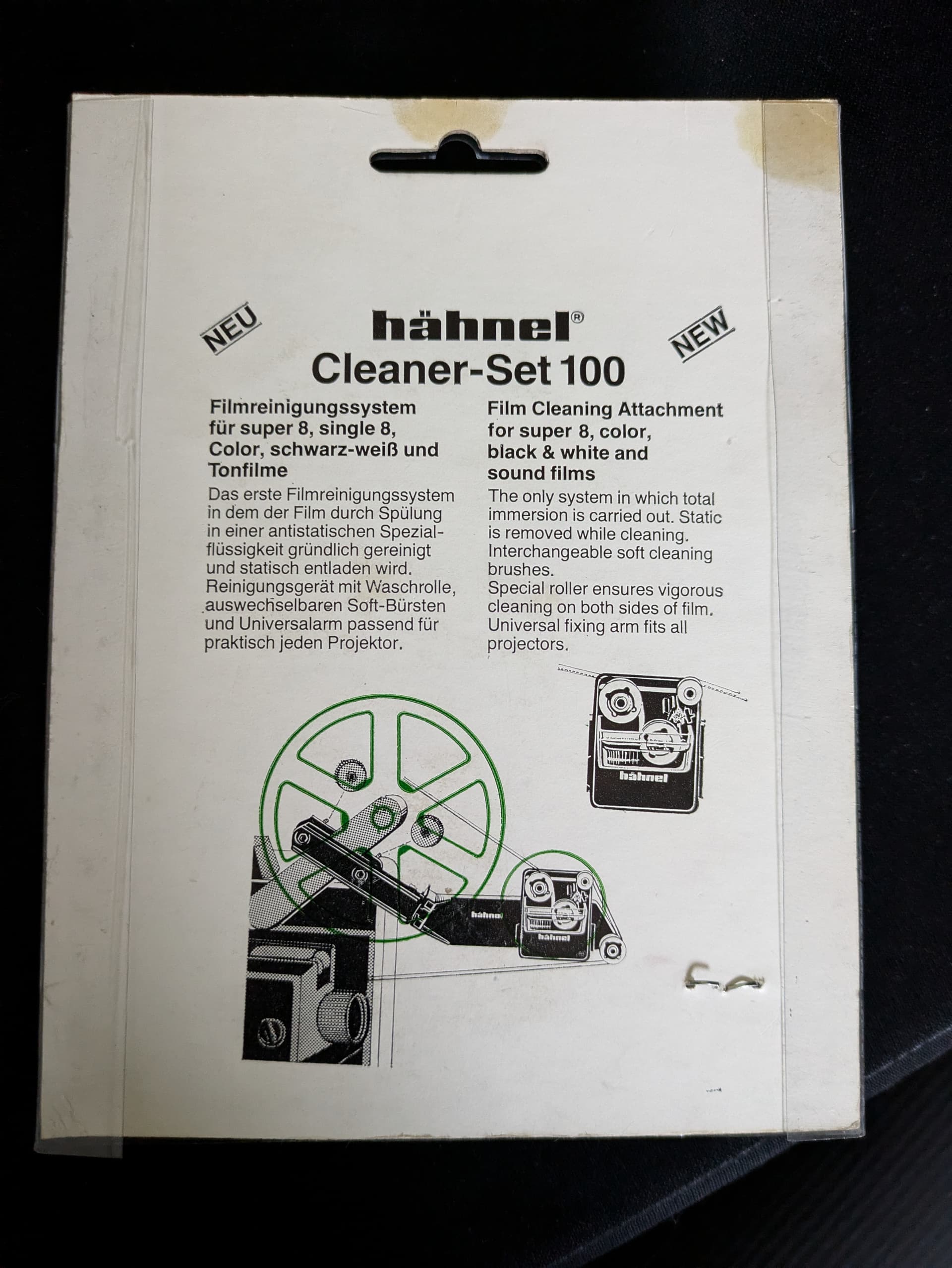

I’ve found this relic alongside the film reels. It looks like new, but doesn’t say what it’s made of. Does anyone know this product? Do these liquids tend to deteriorate over time? Google has nothing.
… seems that the company still exists:
According to their website, they moved 2007 to Ireland and later, 2022, to Hongkong. Claim to be “proud to be a family company still”. While they do not offer film cleaning solutions any longer, maybe they still know what’s in that bottle?

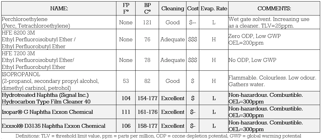

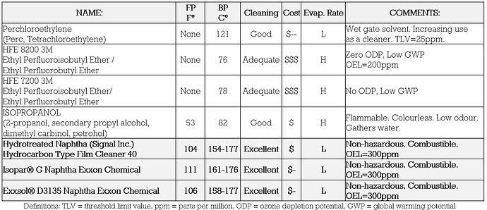

Isopropyl is perfectly fine for film. It needs to be 99.5% alcohol or higher, but there is nothing wrong with using it. Lipsner-Smith and Prista made cleaners based on isopropyl, and Kodak used to have a chart on their web site that listed the various cleaning agents. Isopropanol is listed as “Good” – better than HFE, which was used in Kodak’s own film cleaner.
But does that list apply to sound film, as well?
I’m gonna give asking Hähnel a try. :+1:

Hähnel’s (not too surprising) reply regarding the cleaner.
Good day verlakasalt,
Thank you for your email.
That is a long gone Item, I am not sure if it is still usable. I know mostly water and alcohol, the alcohol part should be long gone with the wind by now.
I am not sure if you still can use it.
Thanks a lot, have a nice day.
I’ve opened it and it hissed a bit (air coming in). There’s a very faint smell of alcohol and an even fainter smell of …soft plastic…? (Maybe from the cap of the bottle. The bottle itself is glass)? Either way I’m as wise as I was before :woman_shrugging:.
