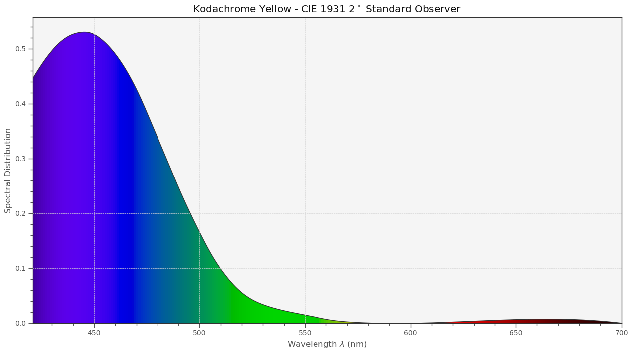

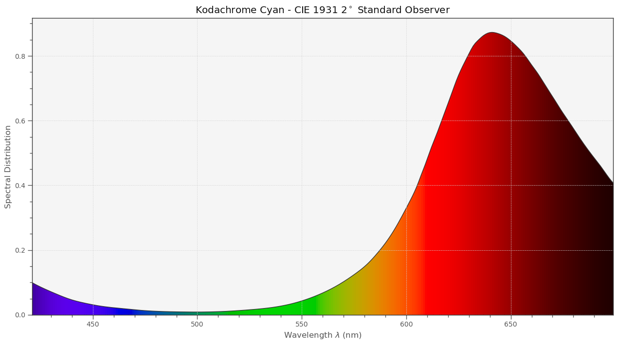

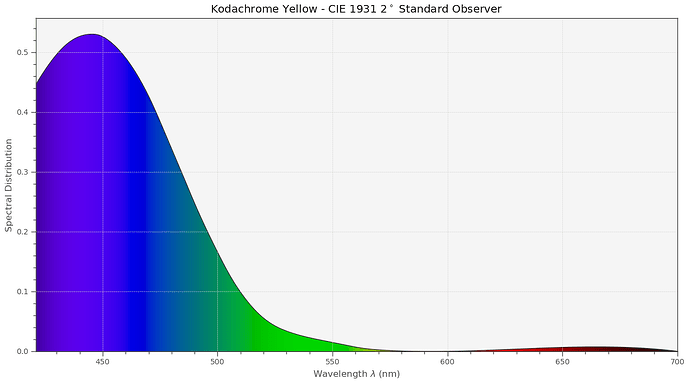

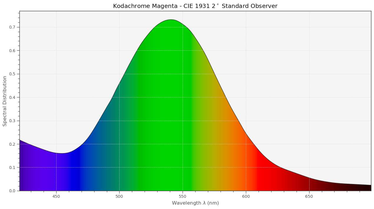

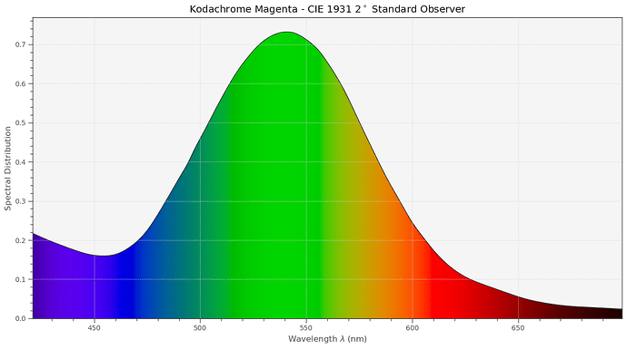

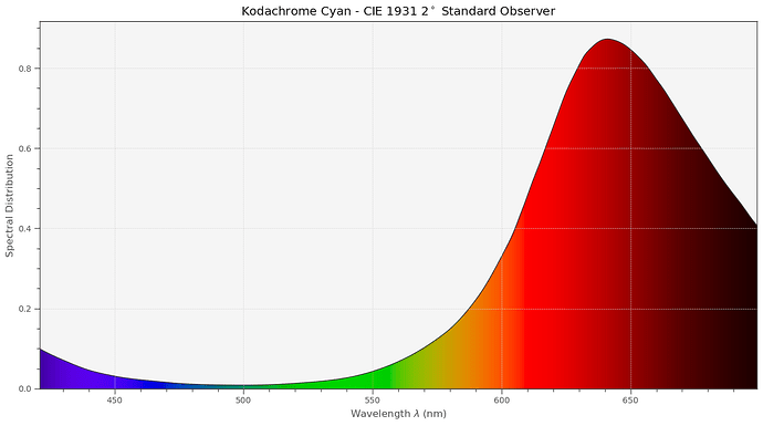

– thanks very much for these links! I actually found out in the mean time that I already had digitized the Kodachrome curves:
You kind of better see the spill between the channels in these diagrams - but I do not know where I got these curves from (most of that stuff was done years ago).

@cpixip In the context of the above charts in your postings, the kodachrome are depicting spectral absorption, unlike the above which represent passthrough response.
That is the reason I inverted the datasheet curves in the above representation.
