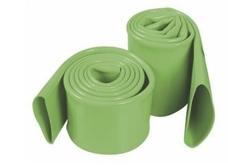

You can buy the sleeves that are made out of the same material as PTRs and they are super cheap.

You can use those perfectly fine for DIY PTRs.
That sounds interesting. Not sure where to get those in Germany (yet), though…
However, is that sleeve primarily for smooth film transport or does it also pick up dust particles like the PTRs supposedly do? Because thats the feature I’d primarily wanted to imitate.

It picks up dust the same way as PTRs do. It’s a very basic clean though. They come in different diameters, so you can use them with existing rollers, eg you could purchase something like this:
https://www.fruugo.us/20pcs-audio-belt-pulley-recorder-pinch-roller-13x6x25mm-for-tape-deck/p-58083812-117896349
And then put the sleeves over them and you should be good-to-go.
