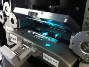

RE: that Lasergraphics machine…
Lasergraphics’ proprietary 2D optical pin registration system locates up to 8 perforations and is able to register the frame even if only one of the perforations is usable. The frame is stabilized in the X, Y, and rotation axes. Therefore, shrunken film can be effectively stabilized with no mechanical or software adjustments. All optical pin registration is performed during the scanning process, eliminating the need for any post-processing.
