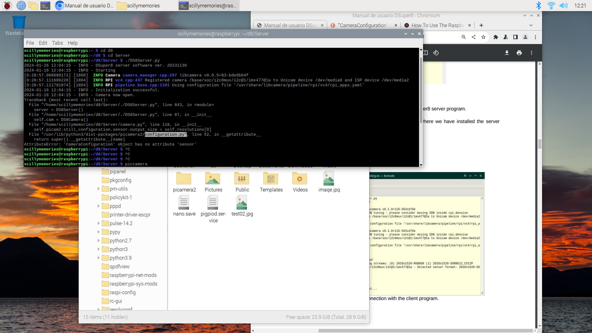

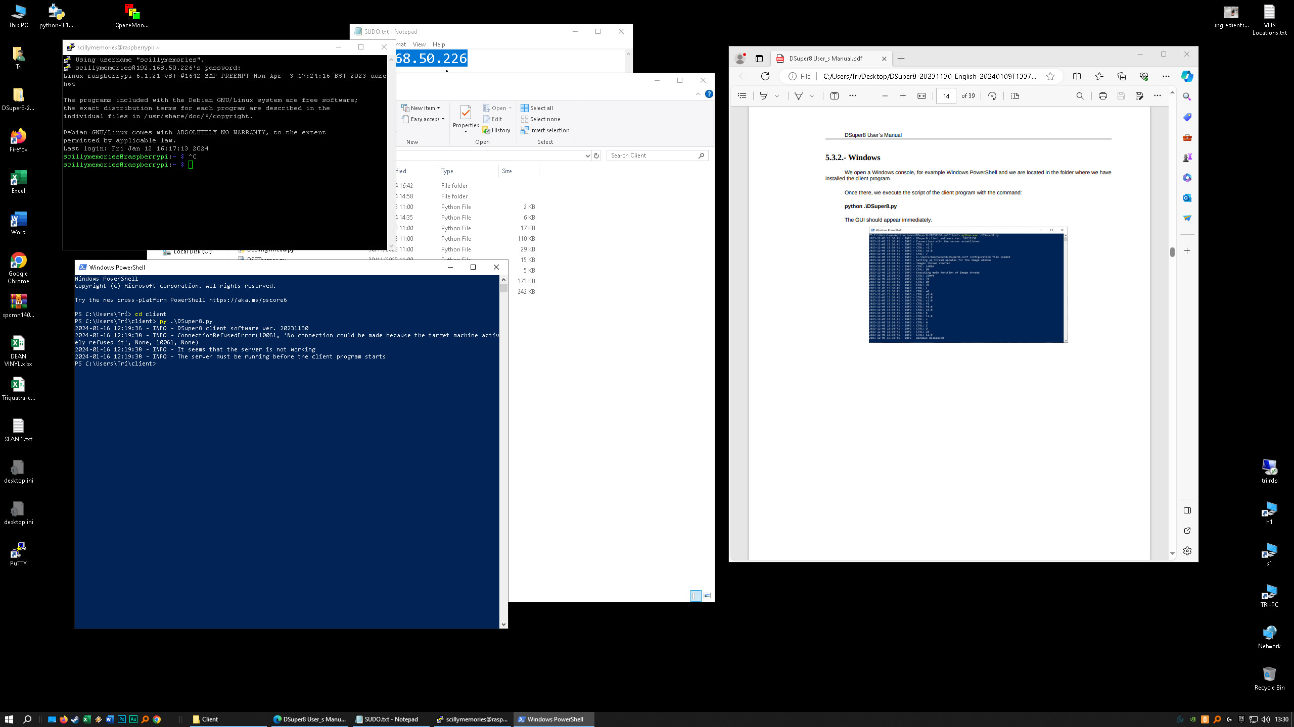

I can connect to the RPi using a PC, but when I try to connect to the server I have set up on the Pi, I get this:
I have followed the instructions as best I can, and I’m fairly sure I’ve done everything right, but I think it may have something to do with this error message that the server is giving when I start it on the Pi

… that was quite fast! :smile:
(seem to be an issue with the camera initialization. There were recent changes (new “sensor” config vs. old “raw” config) which might need to be adapted in Manuel’s software. Can you post the version of picamera2 you have installed, maybe also the OS- and the libcamera-version you are using?)

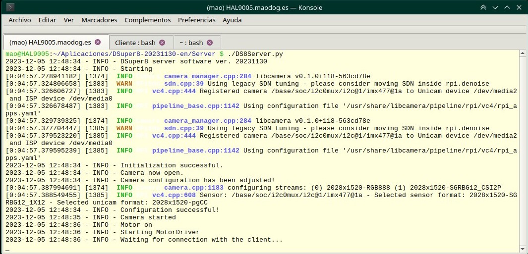

The response of the DSuper8 server after a successful boot is as follows:

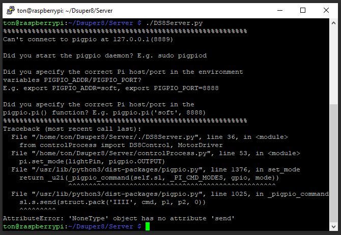

I’m very impressed and decided to use it in my telecine project.
I’ve installed the software exactly according to the manual, but at all attempts I get this:
New fresh installs, updates to latest versions, replacing harware, no matter what I do, I’m not able to boot the server software. It looks like Rowan’s problem, but his solution don’t work for me.
I use RPi4, Python v3.12.2 Bookworm, PiCamera2, Server Software v20231130 and using putty on my windows i7 PC. I really need some help now.
Any thoughts?
Thank you in advance
Tony
Hi @Tony,
First of all, welcome to the forum and thank you very much for your interest and for your kind words.
The error you have reported is due to the pigpiod daemon not being running at server startup time.
You should check the following:
  • The pigpiod.service file that comes with the software must be copied to the /lib/systemd/system/ directory:
    sudo cp pigpiod.service /lib/systemd/system/
  • Once copied, we run the daemon:
    sudo systemctl start pigpiod
  • For greater convenience we activate the daemon’s autostart. In this way it is executed automatically on each restart of the RPi 4:
    sudo systemctl enable pigpiod
  • We check that the daemon is running:
    sudo systemctl status pigpiod
If everything is in order with the daemon active, the DSuper8 server should boot normally.
Good luck
Hello Manuel,
Thanks for the quick respons. It solved the issue. The Server is booting now!
Regards, Tony
