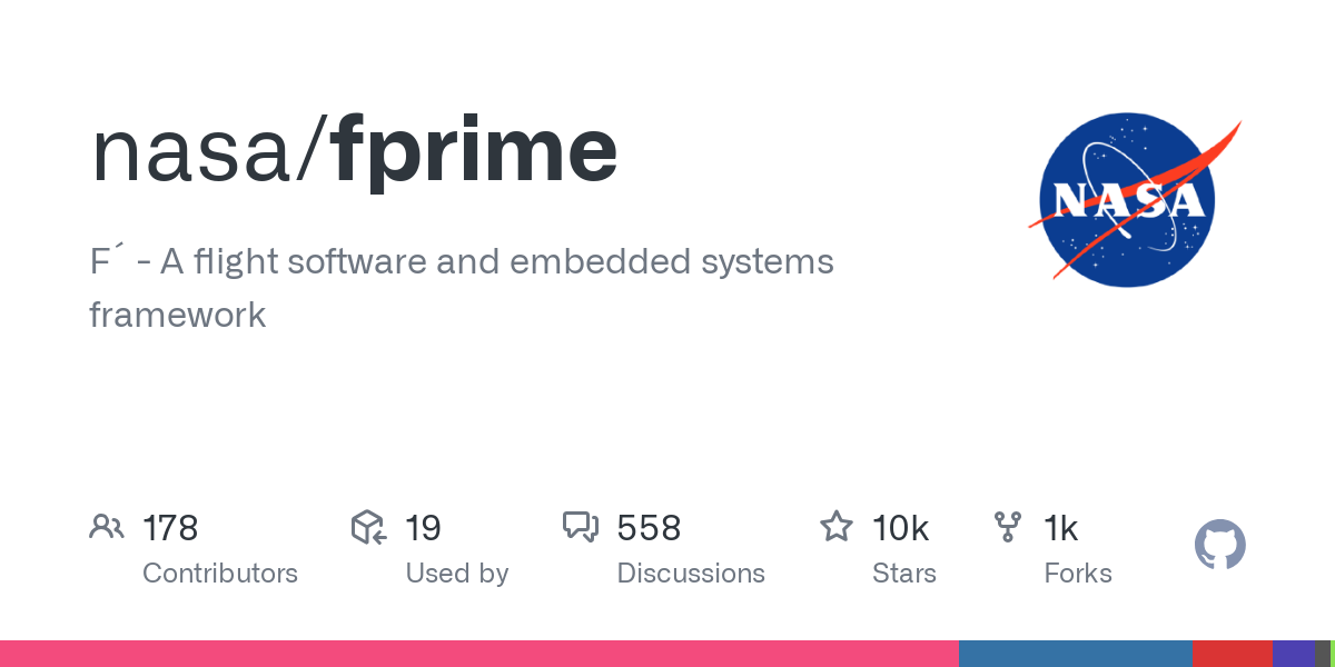

Well, you’re probably want to stay far away from NASA software - that is a deep rabbit hole.
For a good taste of what you have to expect with NASA-software, just have a look at
which is a software for CubeSats and has now fixes and improvements required for the Mars helicopter Ingenuity merged into it. So I think they are actually using this stuff on the helicopter.
You would need to install lots and lots of libraries and compile the stuff for yourself. And of course, it’s not really aiming at standard hardware available to us (well, they have a Raspberry Pi demo section). In any case, that stuff won’t be of any help for film scanner projects.
