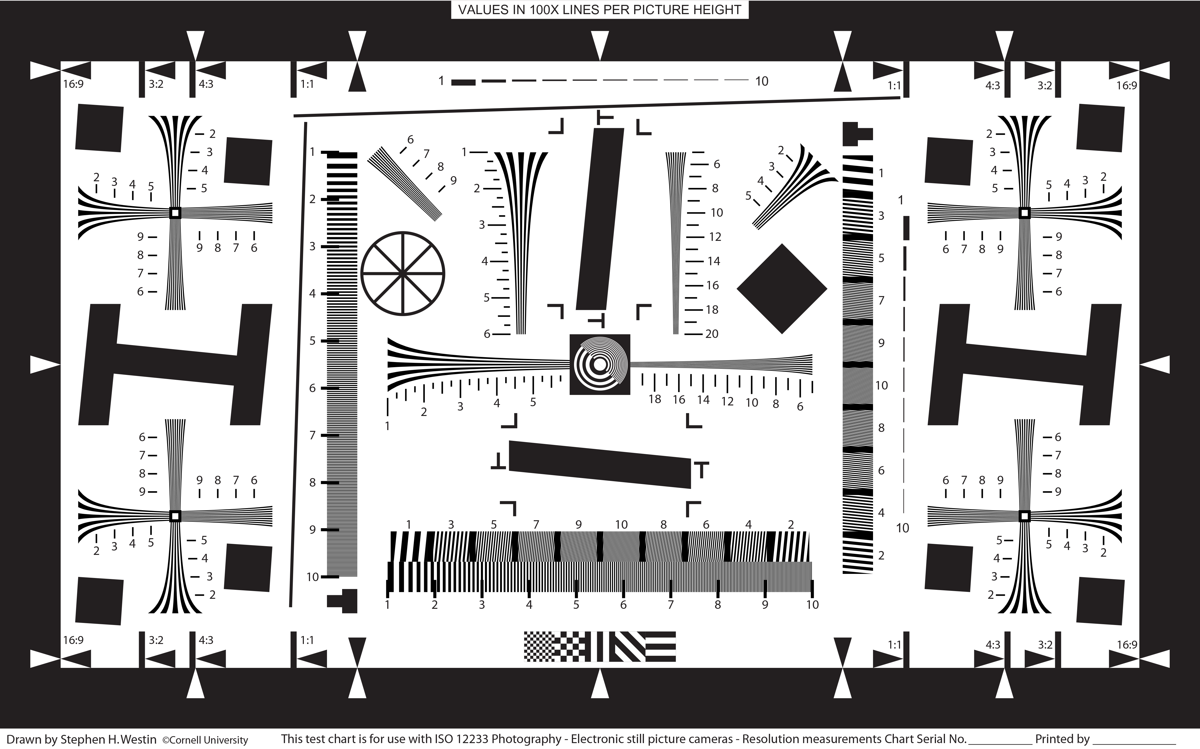

It is a common practice by the camera manufacturers to present the resolution of digital cameras in pixels. But it is easier to get a more accurate idea if the resolution is presented as lpph (lines per picture height) since these results take in to account De Bayering etc.. Are these machine vision cameras have these information?

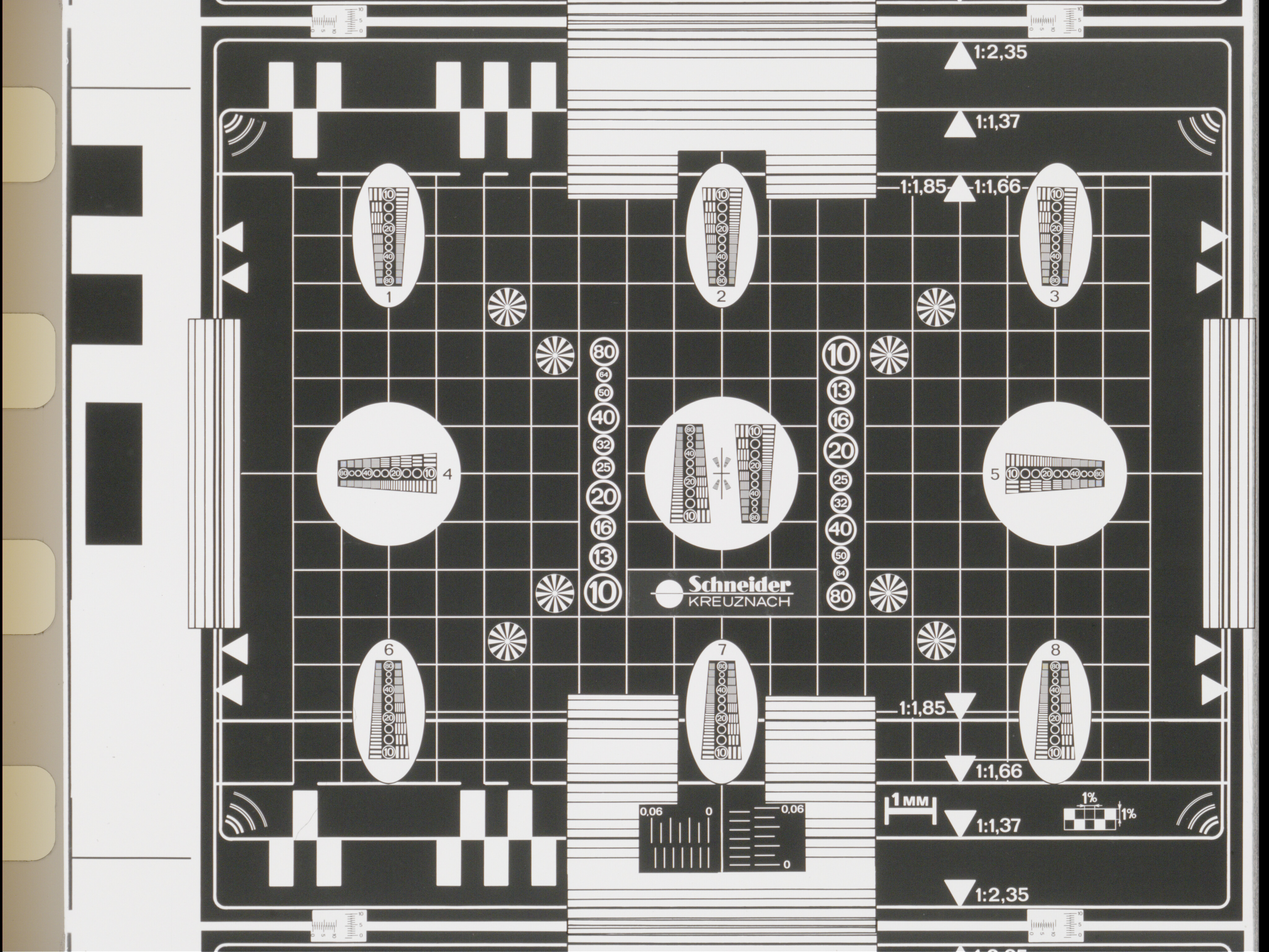

This is a sample scan from Blackmagic Cintel.
the transfer function will depend heavily on the lens chosen as well as the f-stop you are operating the lens with.
