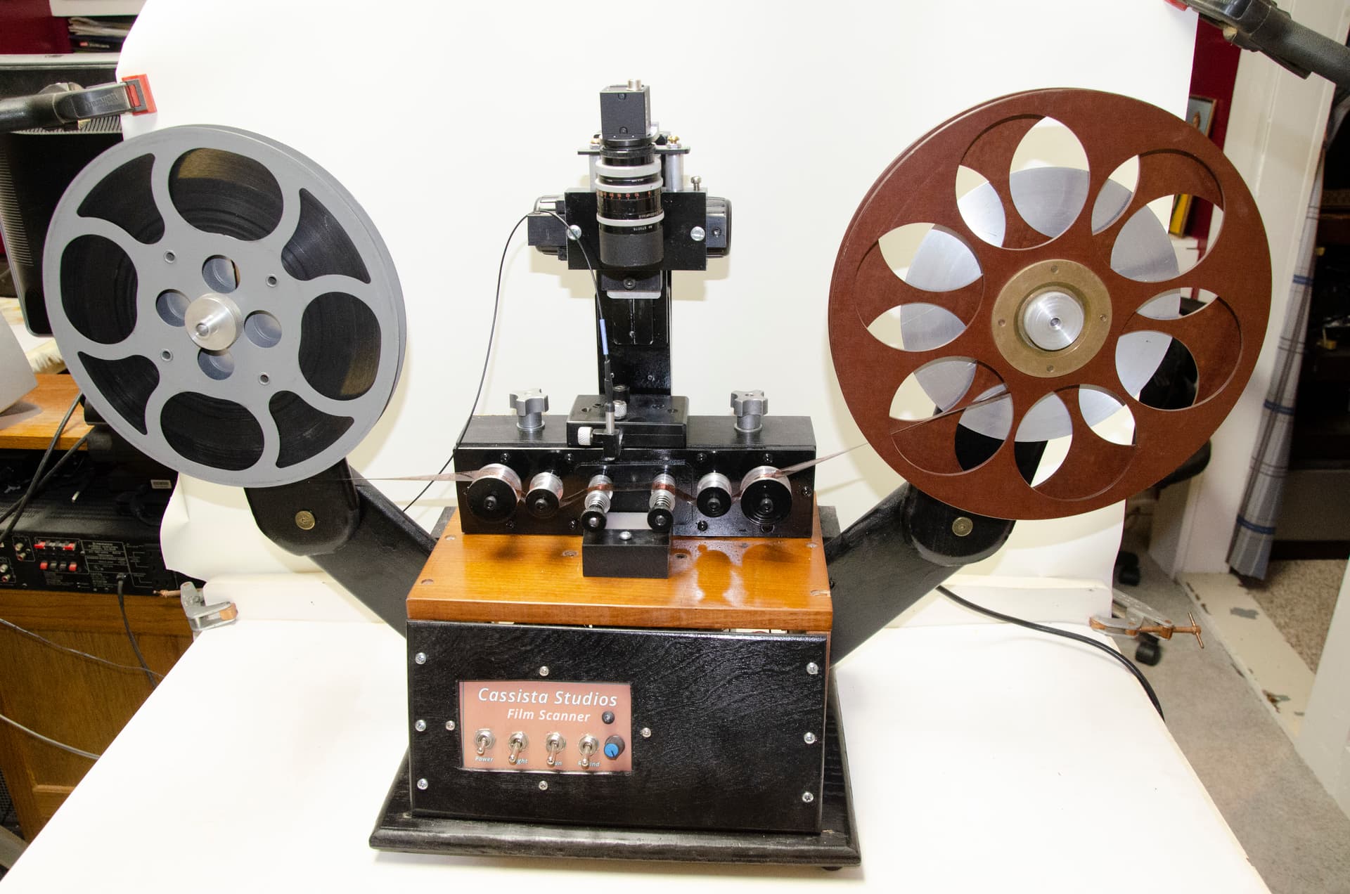

Hello, This looks good, I built a machine almost like this and currently using it to scan 16mm film and I am currently building a more advanced machine to digitize 8mm, super 8mm and 16mm film. It will also digitize super 16mm negative or positive material as well, I am integrating the machine with the DaVinci Studio software and I should have the machine operational in the next month or so.
This is my existing machine. I would love to share ideas and info with you
Al Cassista
