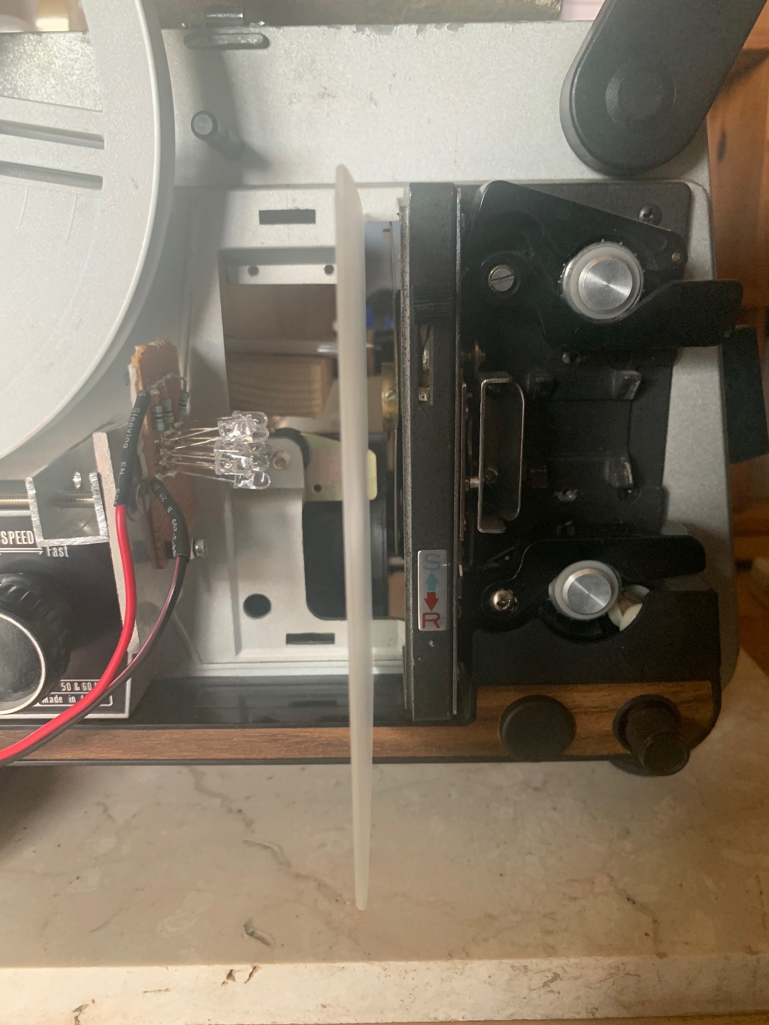

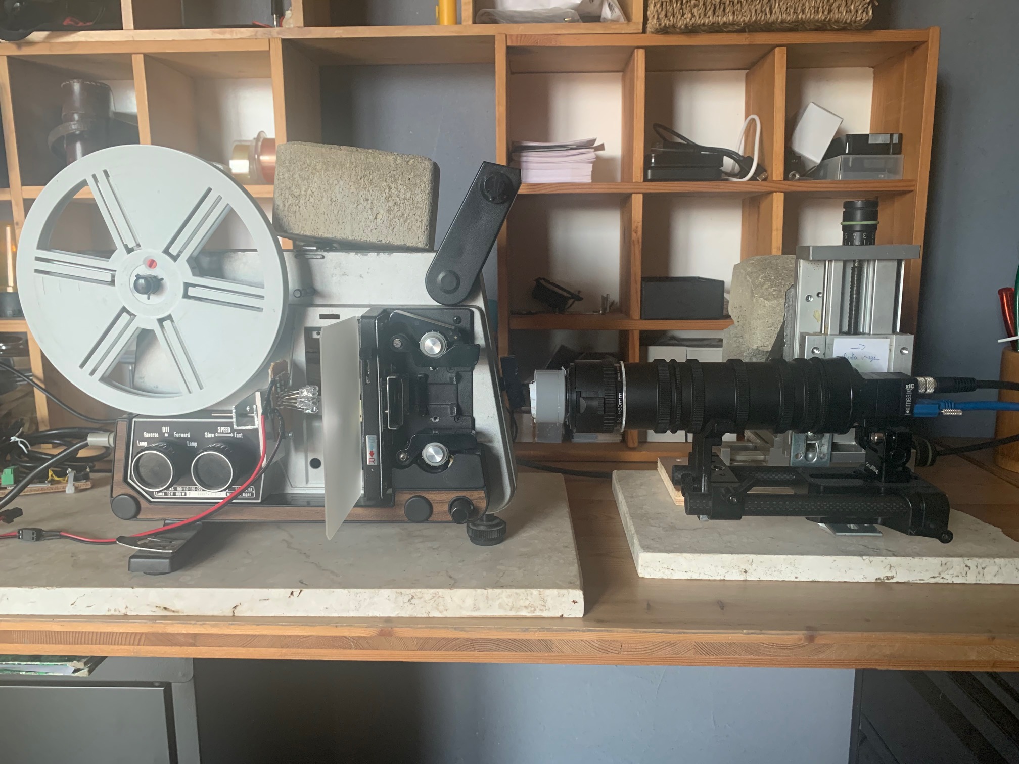

I would like to share my setup and results for scanning super8 films

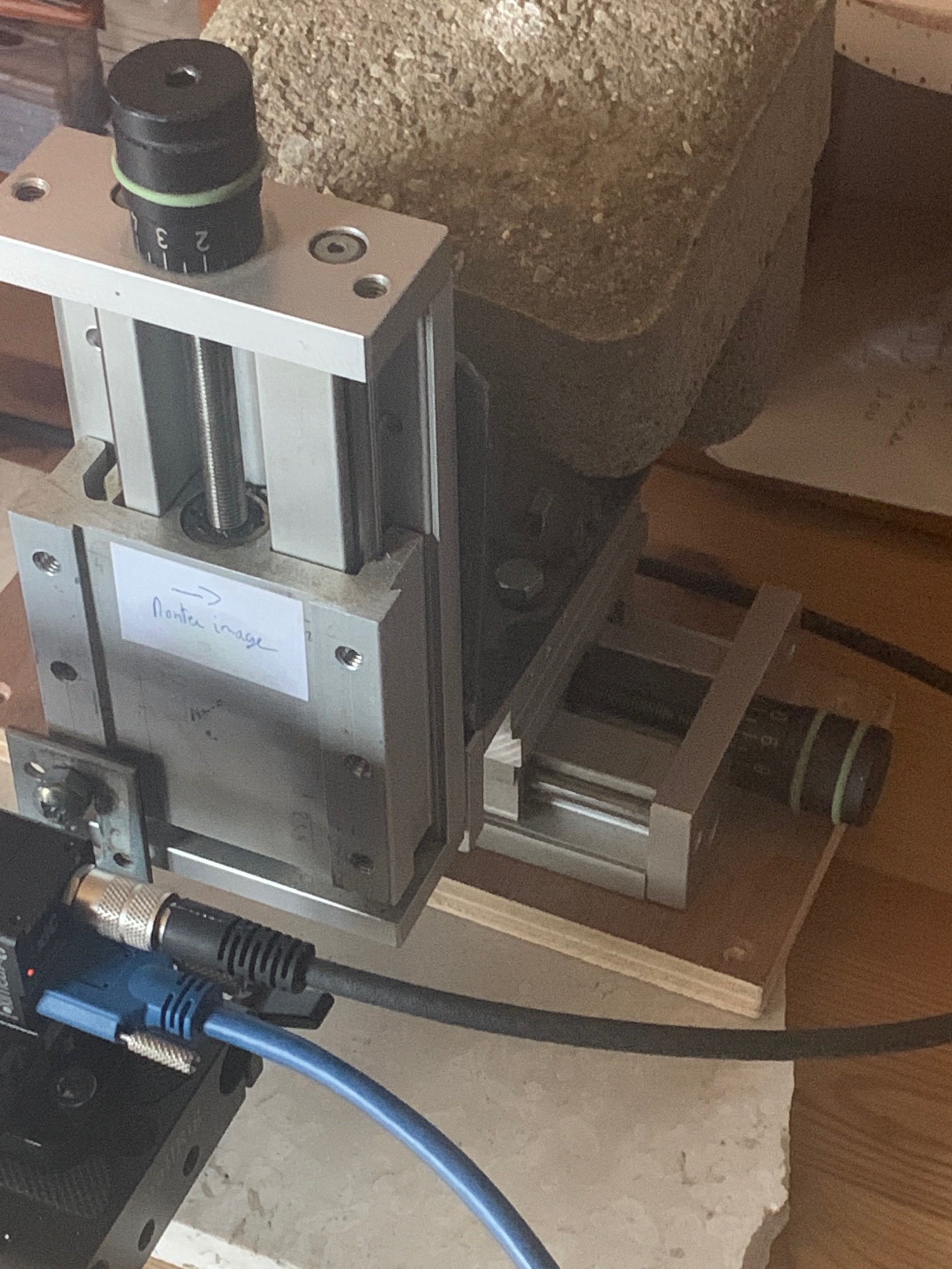

Camera is Ximea MC050CG-SY
old projector
Rodagon 80mm at 5.6 (reverse mounted)
Hall sensor for trigger
9 leds
for light diffusion I use a focusing screen from super8 viewer
stone to reduce the vibration :slight_smile:
Scanned in 2464 x 2056
10 fps
shutter speed 1ms
Raw 16 bits dng
Post in Resolve
only slight adjustments in Camera Raw
no sharpness nor noise reduction
downscaled to 1920x1080

I see that for the capture you use the software of the camera manufacturer, but I would like to know how you control the advance movement of the film.
Cheers.
Thanks Manuel,
No need to be sorry for him, he was useless for the society… In fact, he served as dinner for the fish.

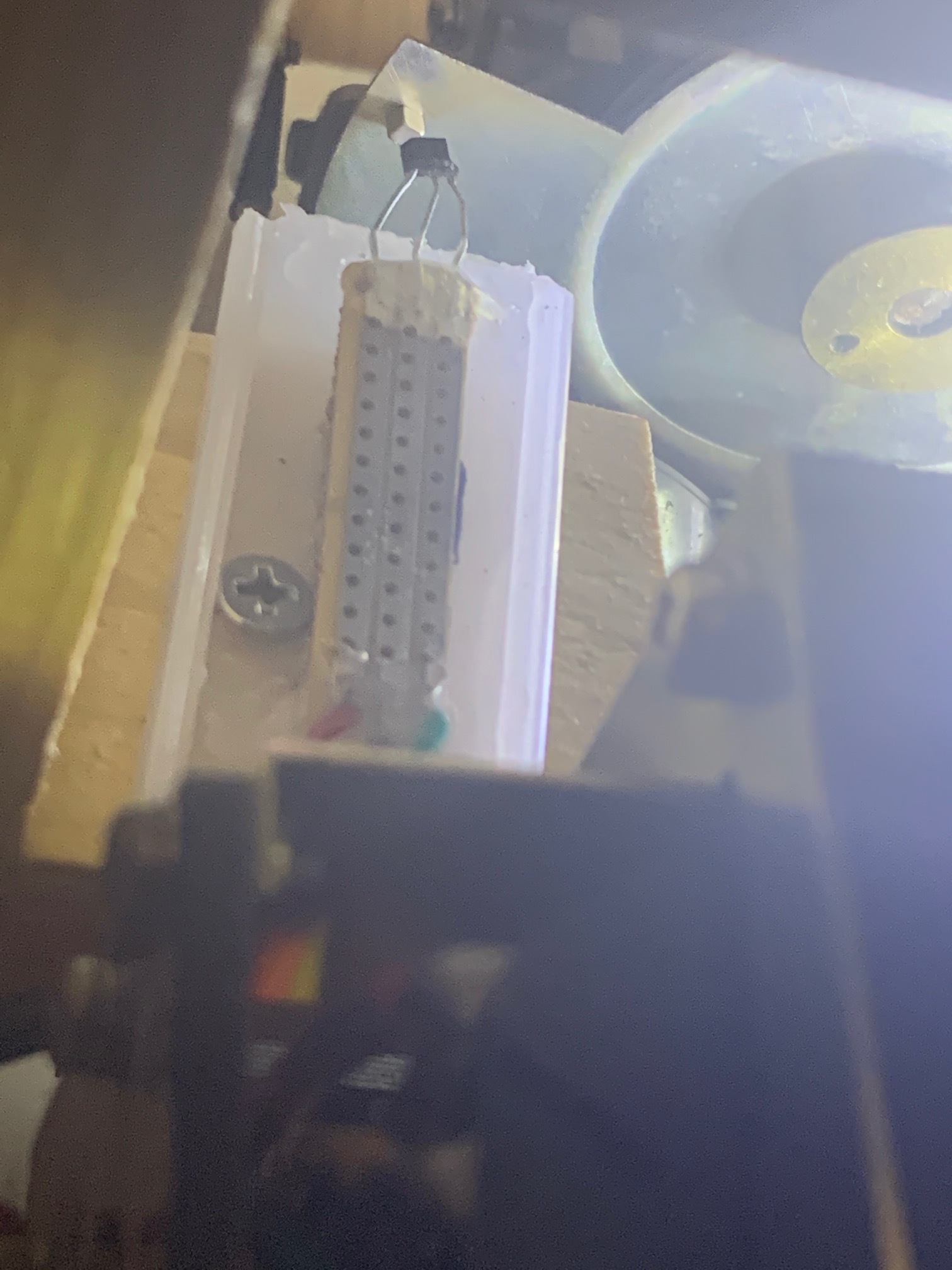

The projector is running by itself. I am using the sensor hall trigger method.
There is a magnet on one of the blades of the projector so every time the magnet comes near the hall sensor it output 5v to the camera trigger
