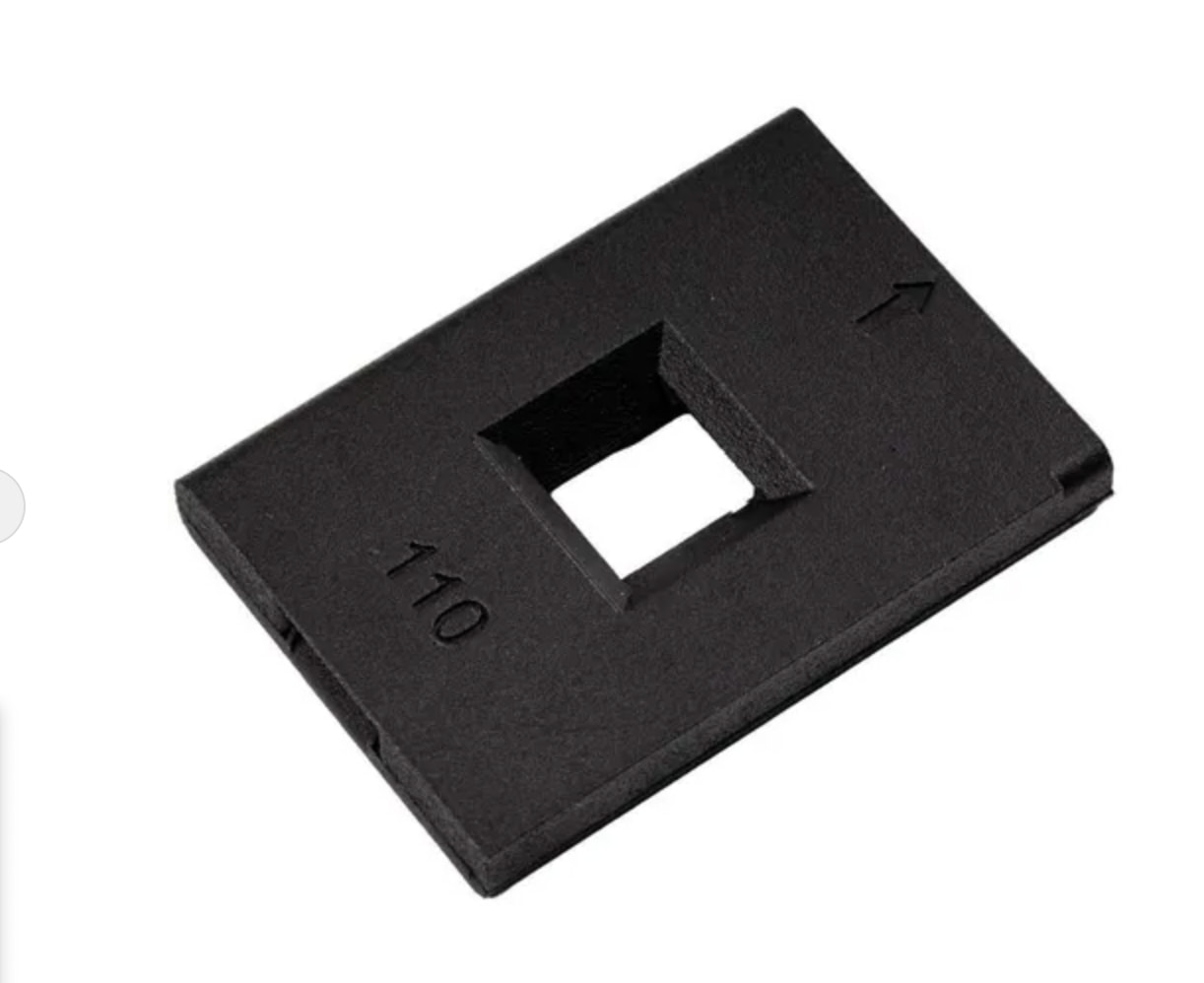

As an almost final step in my at-home setup, I am looking for someone to help me with STL modeling to 3D print a part for my scanner.
I need a part that would fit as a film holder in the easy35, but that would carry 8mm film. All the external dimensions should be the same as the other holders as pictured below, but would fit 8mm film!

I might be making assumptions, but if this is to act as a film gate that the film slides over or through, it should have a very smooth surface to avoid damaging the film. Most 3D printers don’t print that smooth surfaces, but some get around it by then covering the surface with tape or similar, or use something other than 3D printed plastic with a smooth surface.

Hi @Grace_Richardson. I agree with @ChrisCph that it may be difficult to make something that holds the film down, and there is not much space in the slot to being with.
May I ask, have you considered alternatives to the easy35? that is an expensive unit, and you may be able to get something simpler that gives you an open setup… here is an example found in printables (not the 8mm dimensions, just an illustration).
Do you have access to a 3D printer? and a caliper? If you can send the exact dimensions of the picture you posted, particularly the thickness, I can make you a model to try… maybe a curved one open at the top?
Hi everyone, just an update, i ended up ordering the easy35 8mm holder, shaving it down and creating a lego casing so it slots into the easy35. In the future, i hope to be able to model one, but without a calliper and any real modelling knowledge this was the simplest solution for me and allows me to adapt very easily to 16mm
