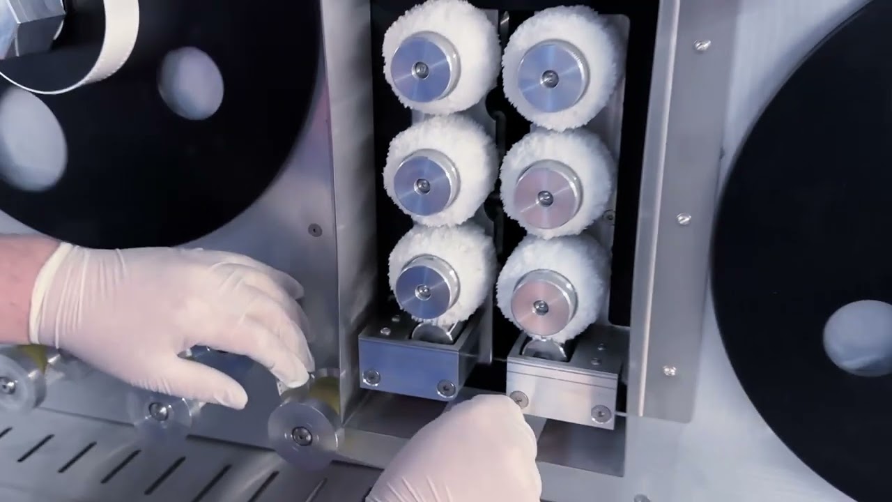

This video just came up on youtube, interesting cleaning machine.
