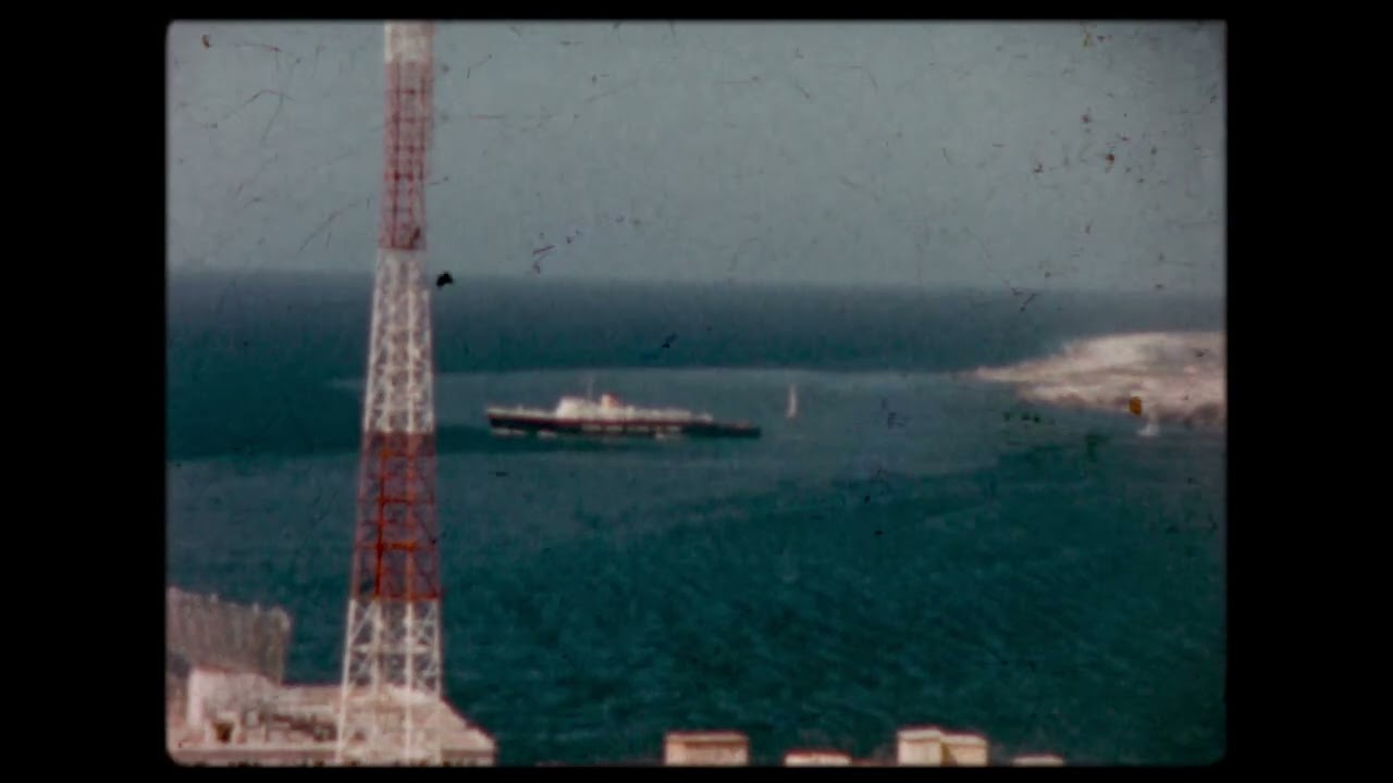

Meanwhile, here is a clip (no noise reduction) processed with the entire full sensor pipeline.
Tingopix -> [TIFF-RAW Sensor 16bit] ->
Debayering/sprocket referenced cropping -> [OpenEXR Float] ->
Davinci Resolve 20 -> h264*
(* I don't have the studio version yet).
