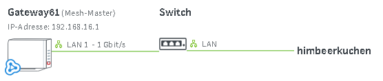

This is how it appears in the router menu when the connection is only half-there.
Currently I can ping the Pi (IP and name), but the Pi can not ping my Windows PC or access the internet. SSH/VNC doesn’t work.
Now I rebooted, the Pi is online, pinging goes both ways, ssh works. My router says… the same as before :smiley:… I’m positive I had seen an extra icon when the Pi was online before, but I guess not today. So much for that.
