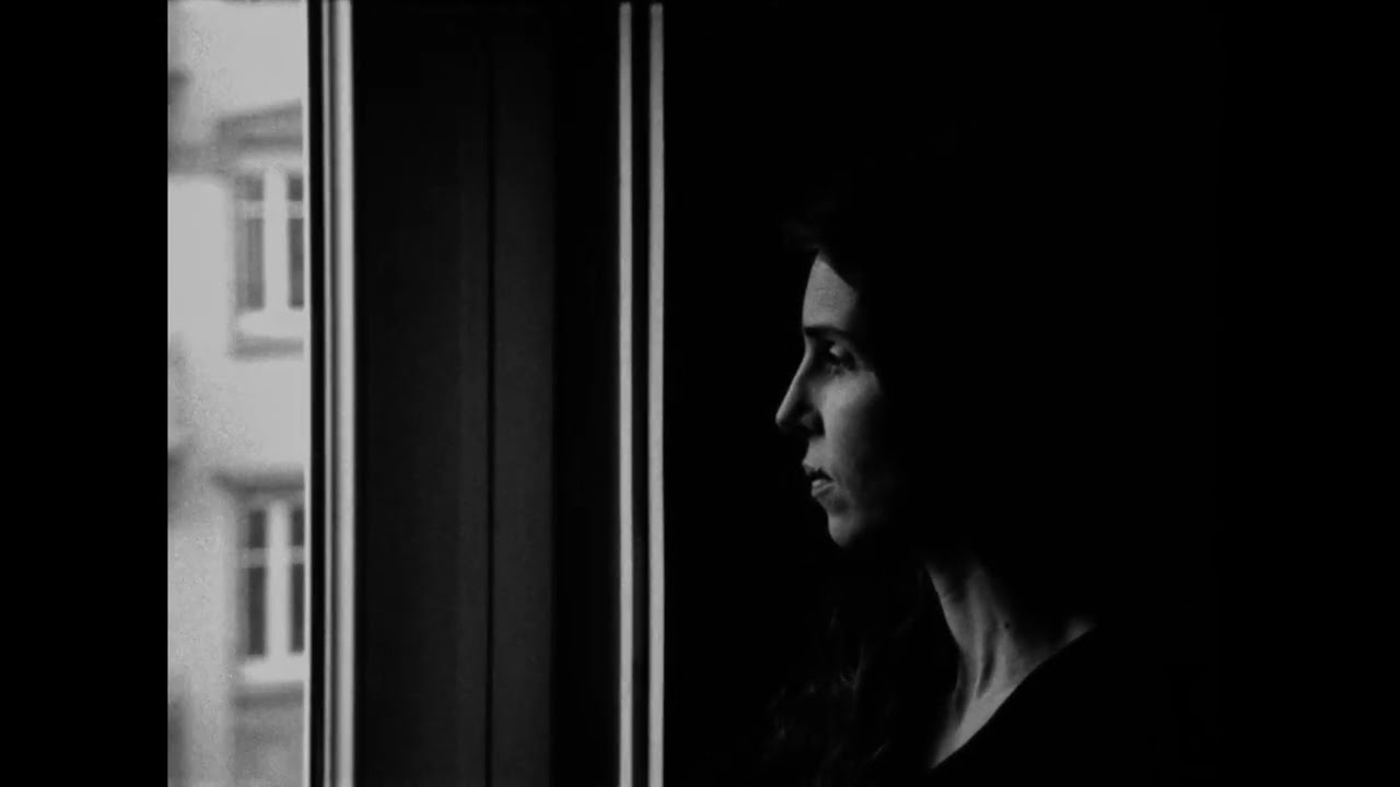

I got some flickering problems on my 16mm scans, you can see it on the wall between the window and the woman here:
As I’m filming myself, processing myself (Trix / reversal) and scanning myself… I don’t know where the problem is. It’s impossible for me to see if the problem is on the film itself as it’s really subtil.
Is the problem coming from my light ? but I don’t see any problem in the highlights…
Camera ? perhaps a equation between LED and exposure time ?
Or cam + process ???
So, if somebody had this problem, I would be very gratefull to have informations.
Thank you, cheers !
Gregory
In order to isolate a little bit the problem, you could re-scan the above example film with the film transport deactivated. In this way, your camera sees only a single, fixed image. If the flicker still persists, it’s not on the film (which is static now), but with your camera/light-source setup. If it’s gone, the issue is more related to the film source/film development/movie camera.
From what I see in your footage, I think it might be a sync-problem between your light source and your camera. If you are using anything similar to a dimmable LED source, you might encounter a beat between the (high) frequency of the pulsed LED source and a similar exposure time of your camera. One test to conduct here would be to change the exposure time of the camera drastically, say to at least half a second or longer, and see if the beat still persists.
By the way - I think the flicker is all over the place, it’s visible in the shadows as well as the highlights.
