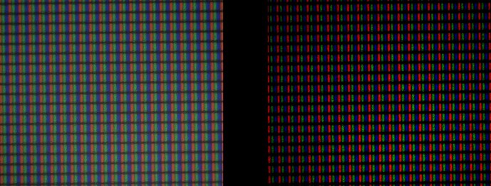

I mounted it on a 2/3 sensor with 10 cm extenders, so that I can frame the printed area of the frame, but I’m noticing a bit of vignetting:
I used the photoshop levels on the right to better show the issue.
Does this happens to any of yours too?
Thanks.
What is most used is the 50mm f2.8 Componon-S, the specs for it here. With either the Componon-S or the Nikkor EL (also f2.8 50mm) I have not seen significant vignette. Used both with a D3200 DSRL and the Rpi HQ sensors.
I see. I knew it was f 4, but I got it for about 12$ on ebay so I wanted to try.
For the moment I’ll continue to build the scanner with with lens.
Thank you very much.
