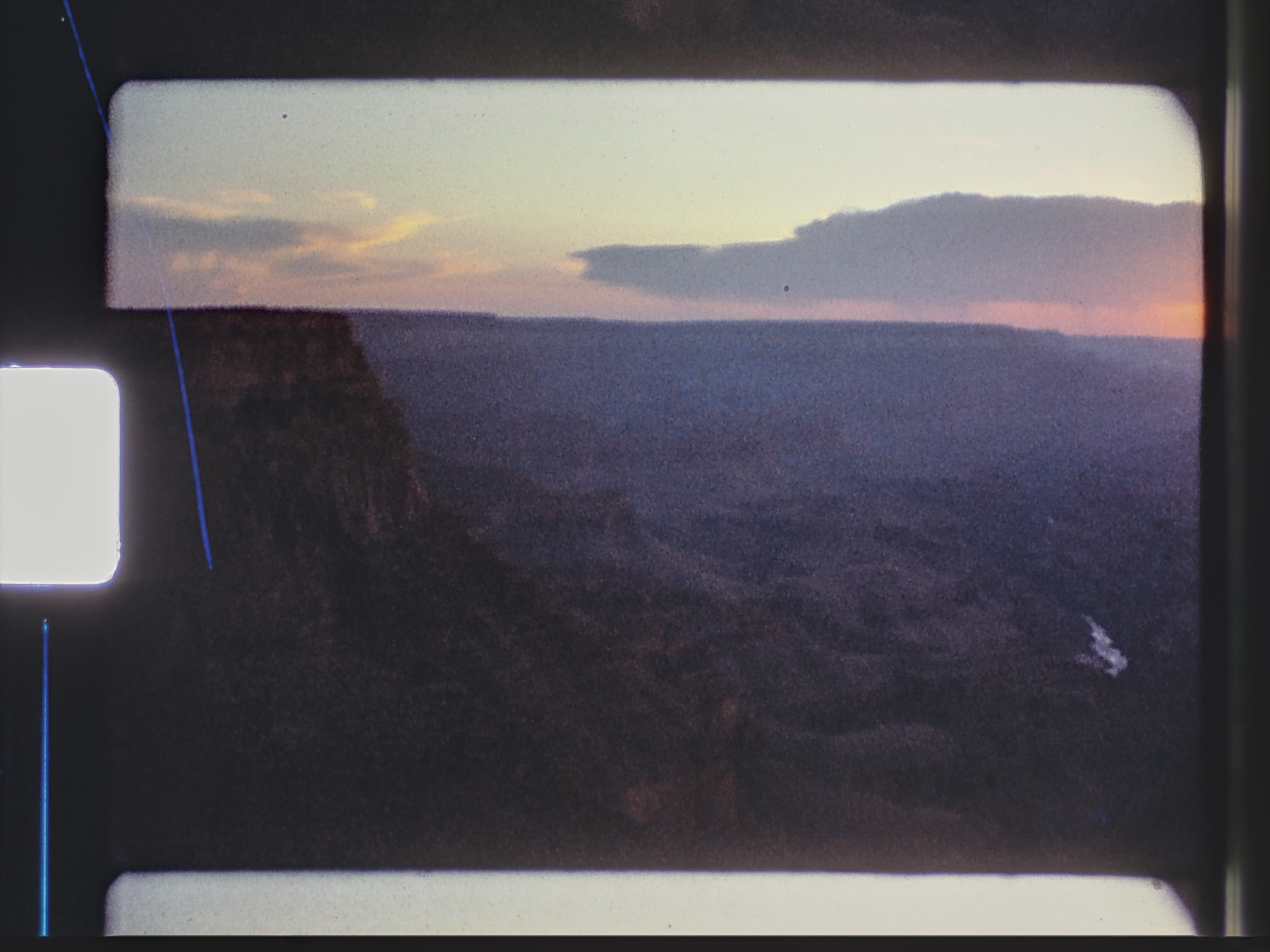

The following scene is such a case. It is a Grand Canyon sunset, again on Kodachrome 40 that was developed about a year after exposure. The scene combines a bright sky with very dark canyon walls, so like all examples so far it was scanned in HDR mode. On top of that, the clip carries plenty of dust and a few scratches.
Here’s an example of an input image - a “raw” HDR scan:
Processed with the default parameters, the grain is reduced, but dust and scratches survive the processing (this is intentional behaviour for best-mode).
The above input image with default parameters prcessed yields this:
For the optimized version, a few parameters were changed. Processing happened in a single pass.
