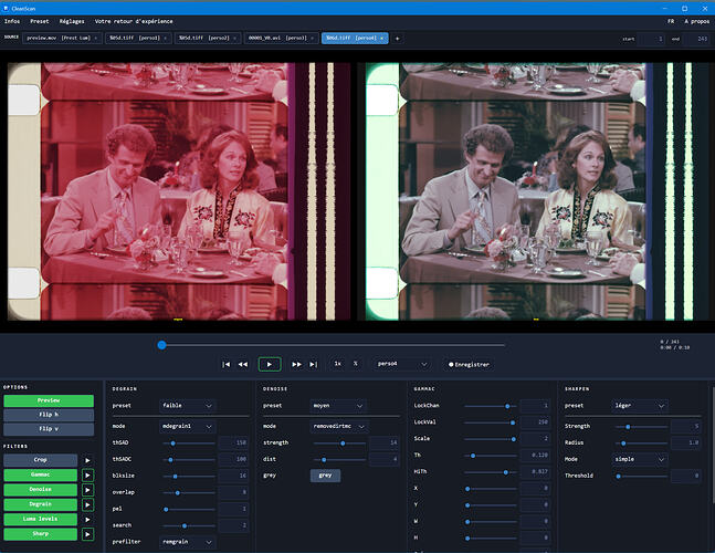

ClearScan – AviSynth – color correction software
I’m sharing a small piece of software I tinkered with over the past few days after the difficulties a user ran into on this forum. I figured that getting acceptable, consistent color settings across an entire film is really a job in which each of us has lost a few hairs.
This software uses AviSynth and a color-correction filter, GamMac, along with a few other basic filters. Let it be said that I’m not a specialist in writing the scripts needed to make these filters work properly, and some of you certainly do it much better—your suggestions for improvement will be welcome.
This tool has the special feature of offering a script/VirtualDub interface that makes it easier to use.
The application folder contains all the required DLLs as well as the latest version of VirtualDub. The user’s only task will be to install AviSynth+ on their workstation (very simple—default options only). AviSynth is detected automatically, and if it isn’t found on your computer, you’ll be given a link to download it.

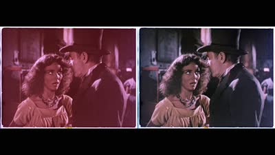

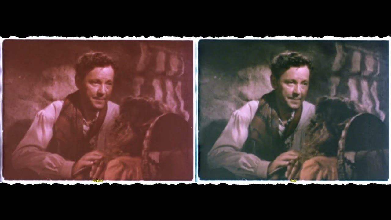

The color correction isn’t perfect, but it already prepares the footage very nicely for grading in DaVinci Resolve.
All DLLs are x64, which allows good processing speed and no limitation on image resolution (you still need to be reasonable, but it’s OK for 4K).
There’s no installation required. Just unzip it to the folder of your choice and run CleanScan.exe.

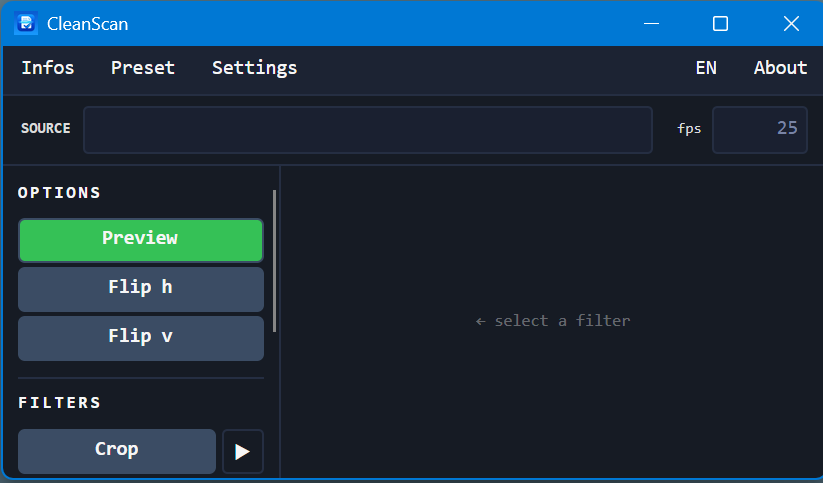

A new beta 2 version is available.
There are so many changes that I’ll give up trying to list them all, and some of them are truly innovative.
The program is now even simpler and more intuitive to use.
A user guide and tooltips will help you whenever needed.
Let me just remind you that no installation is required. Simply unzip the folder and click on CleanScan.exe.
If Avisynth+ 64 is not installed on your computer, the software will let you know and tell you where to download it.
No other software or DLLs are required — everything is already included in the folder.

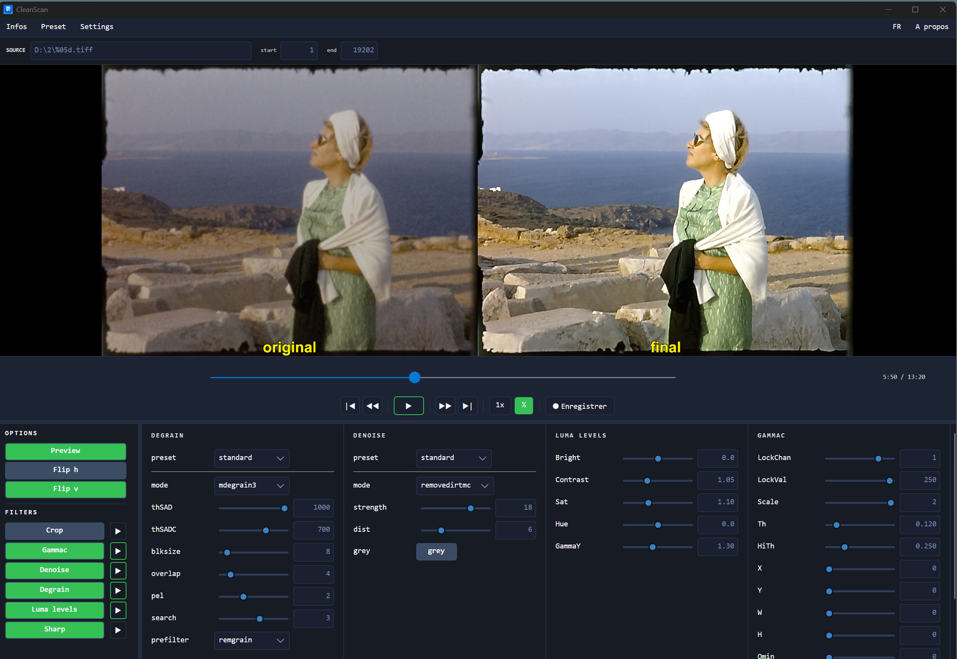

Beta 3.0: a major step forward
This new Beta 3.0 introduces numerous improvements and significantly expands the application’s capabilities:
  • Built-in video player
  • Drag-and-drop support for all video files and image sequences
  • Extensive compatibility with a wide range of video formats
  • New filters and many improvements
  • Easier parameter adjustment with sliders and mouse wheel input
  • Preconfigured presets for Denoise, Degrain, and Sharp filters
  • Ability to display multiple filters simultaneously, depending on the user’s needs
  • Significant optimizations for faster processing and smoother playback
  • One-click selection between FFMS2, L-Smash, and LWLibav
  • Output file creation directly from the application, with several codecs and containers to choose from
  • Export of image sequences in various formats
Features carried over from previous versions:
  • No DLLs to install, only AviSynth+ if required
  • All application settings can be fully saved and recalled through an unlimited number of presets
  • Simple and intuitive interface
  • 4 available languages
  • Complete documentation
  • Detailed tooltips for every setting
