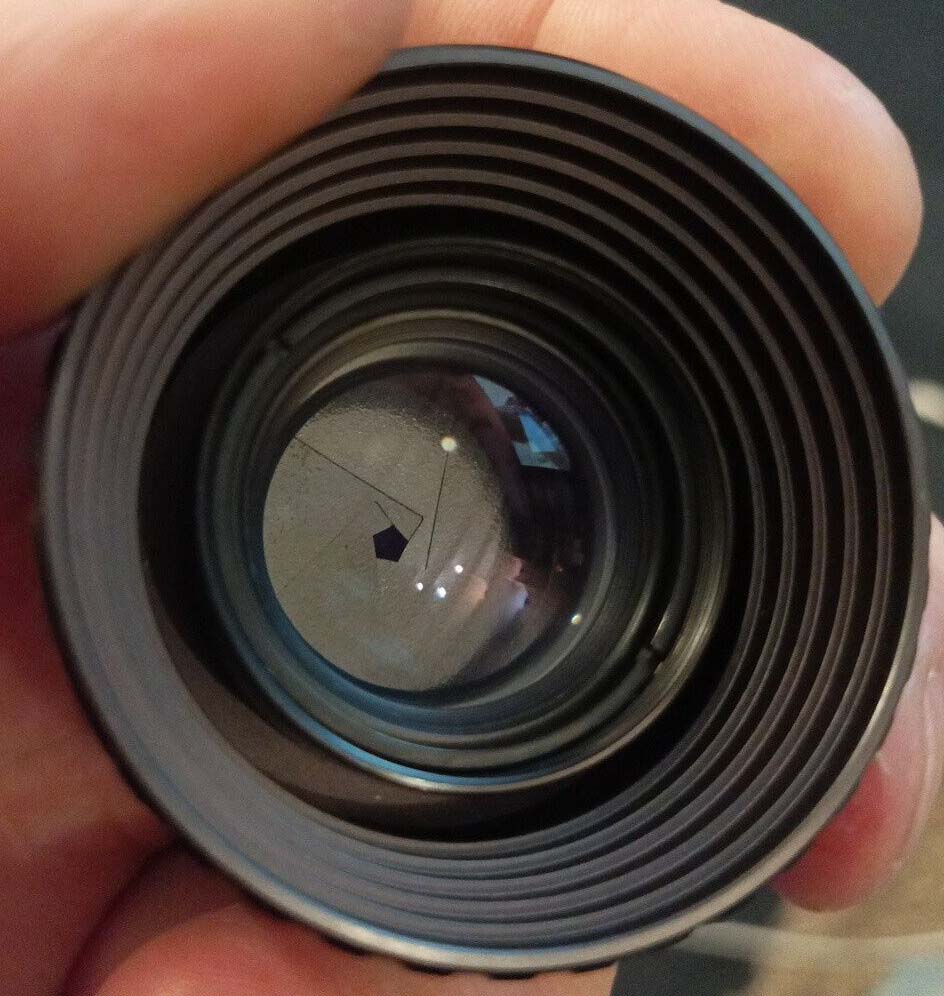

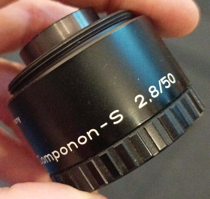

Stupidly didn’t check if the front had filter thread when bought it off ebay.
The lens I got:

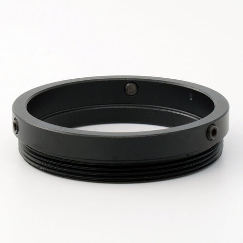

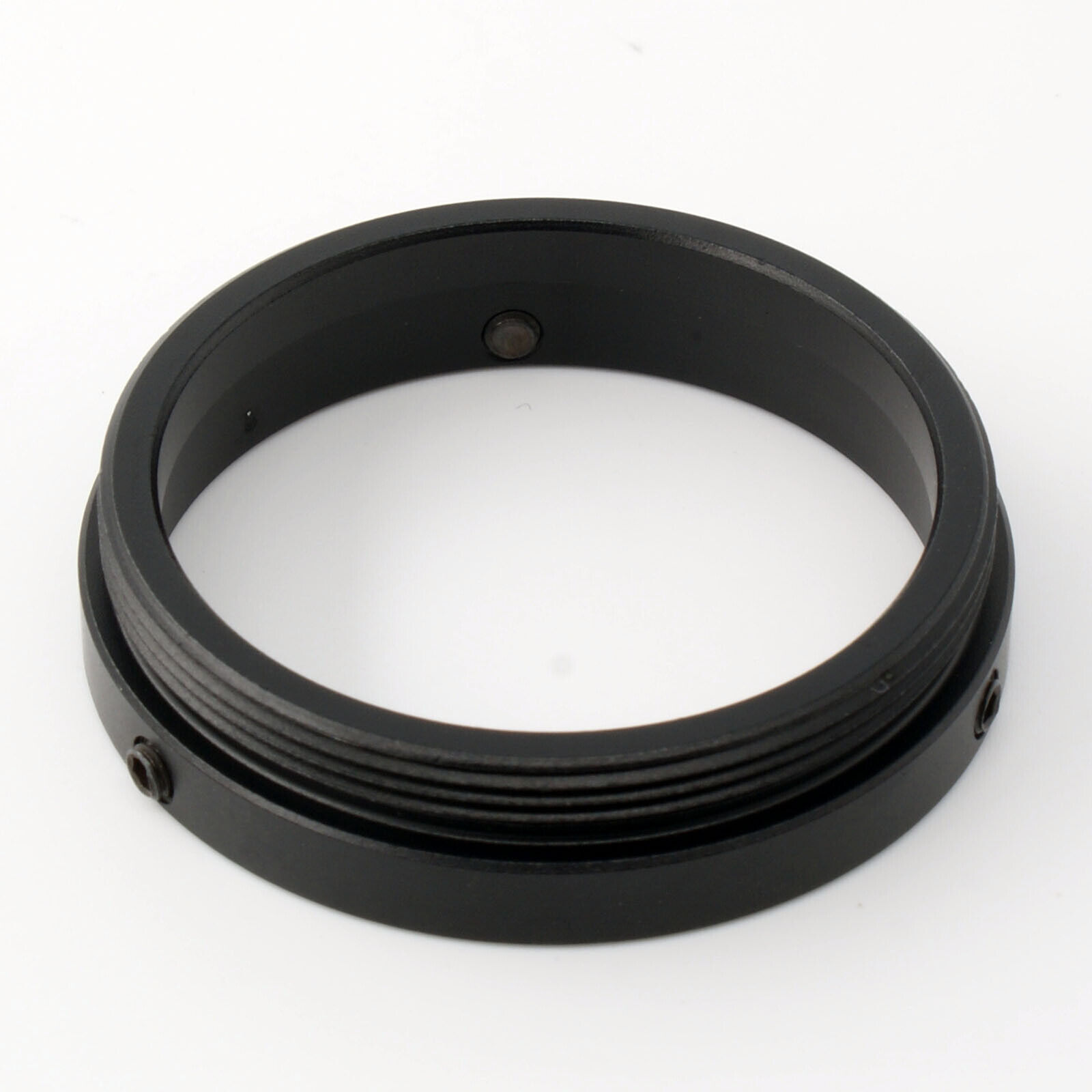

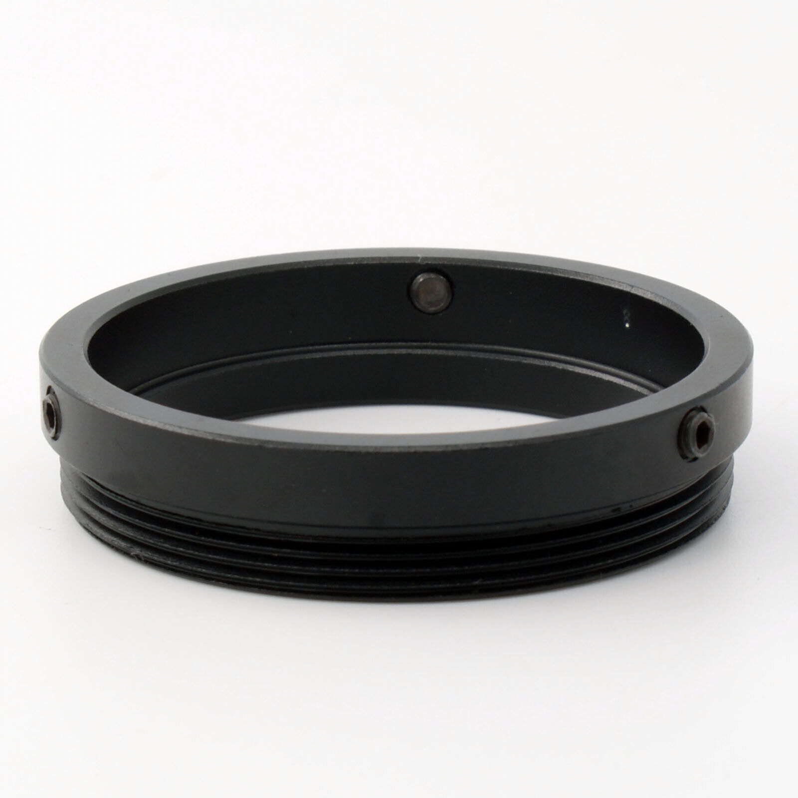

Is the attached “V-M42 Lens Adapter for Schneider Lens” what I need to be able to use it in reverse?
The lens I got:
From other pictures on the ebay listing, looks like the adapter is used with a lens that has a V groove.
The Componon S 50mm f2.8 typically has a 43mm filter ring see specs. If your lens is the same diameter, that 42mm probably would not be large enough to be on the front of the lens. But I may be missing something.
I measured the outer diameter of the lens and its 45mm. I think that 43mm in that spec sheet was for the threaded part which I dont have.
Looking at the ebay listing (V-M42 Lens Adapter RingSuit For Schneider Lens V Mount Adapter M42 Screw Port | eBay) it looks like its for 38mm lenses. Oh well, will keep looking.
Edit: Looks like this would fit. Bit expensive though for what it is though.
Correct, The threaded part is what I called the filter ring.
I bought my lens (in 2021) for $40. I think you may as well keep an eye on ebay for reasonably priced lenses and get one with the threaded ring in it.
