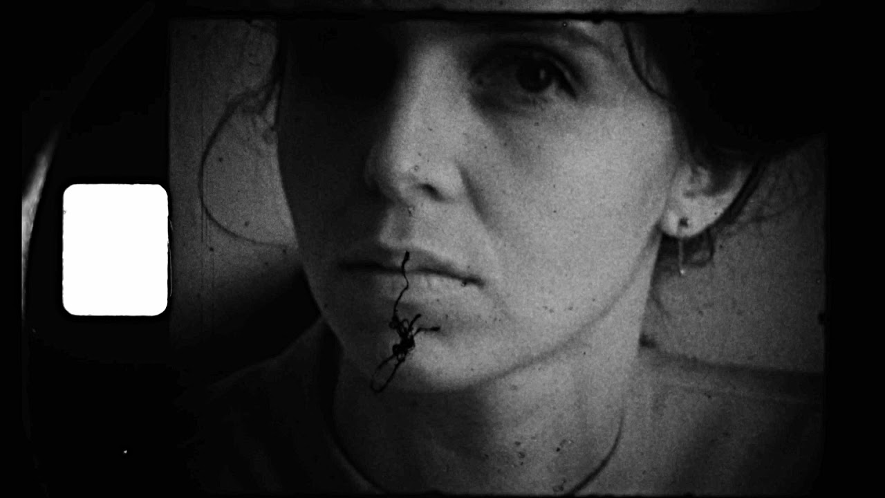

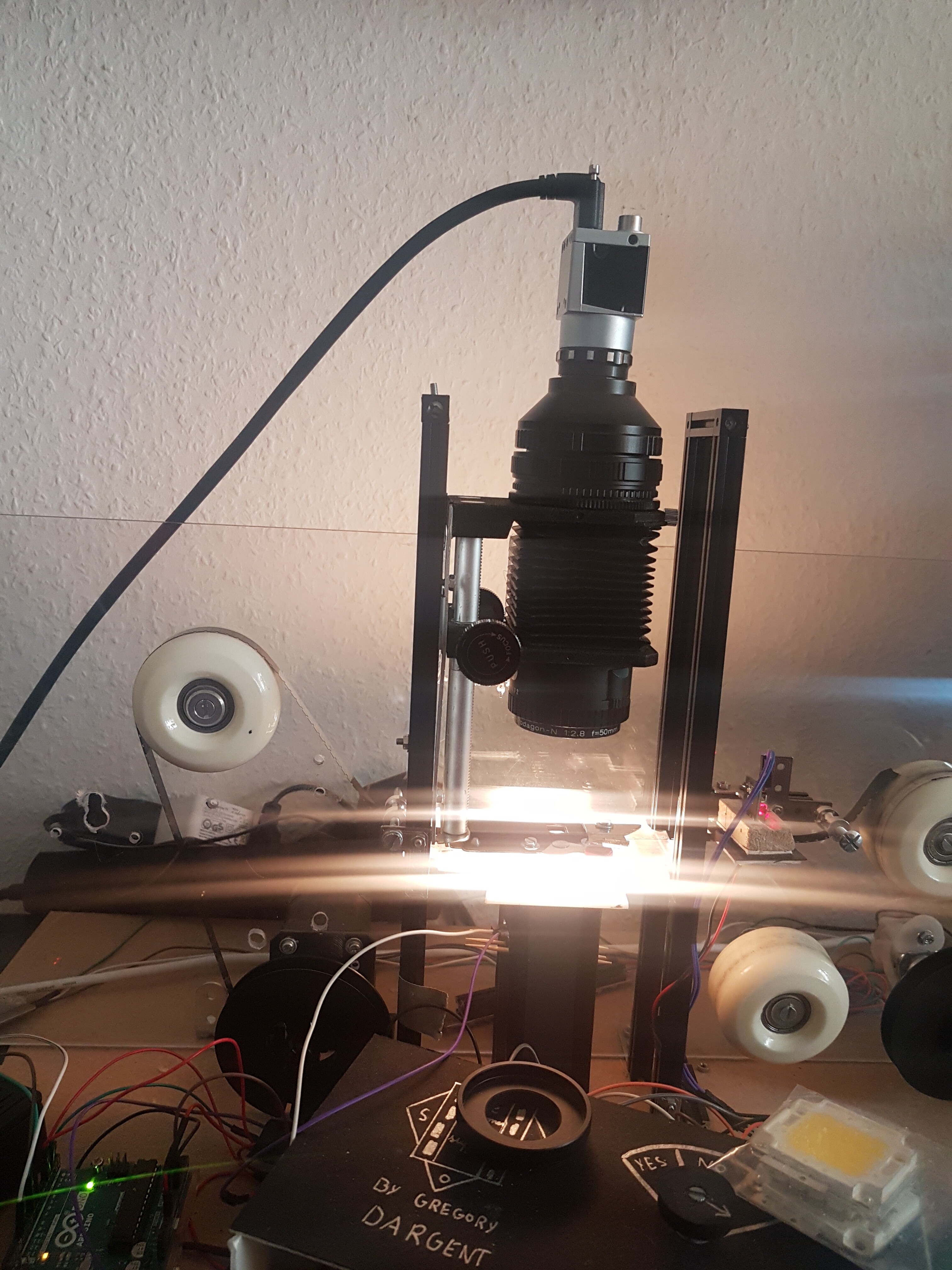

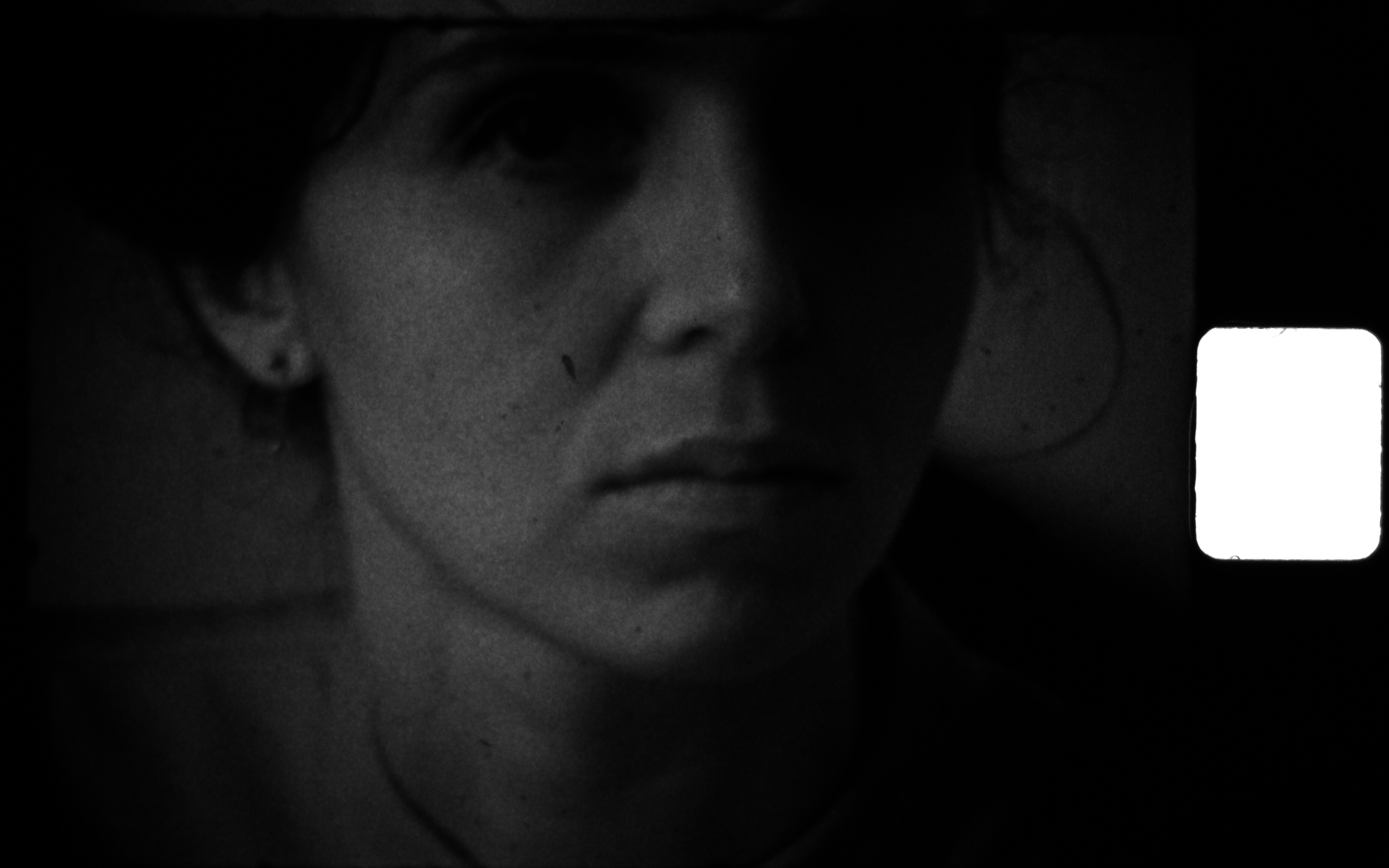

Here is an image of the setup, a still from my test strip (underexposed and dirty), and a short sequence, without straight focusing (I was working more on programming than focusing :slight_smile: ) For the sequence, it’s the B mode from my S8 cam, so I’m not filming but taking pictures with longer shutter times, that’s why it’s shaky and sometimes flickering (I’ll do an other test with 18fps film later).

Wow- that sprocket hole is super stable…
That sprocket hole is stabilized :smiley: You can see the gate’s frame on the left, moving so you see the stabilization needs
