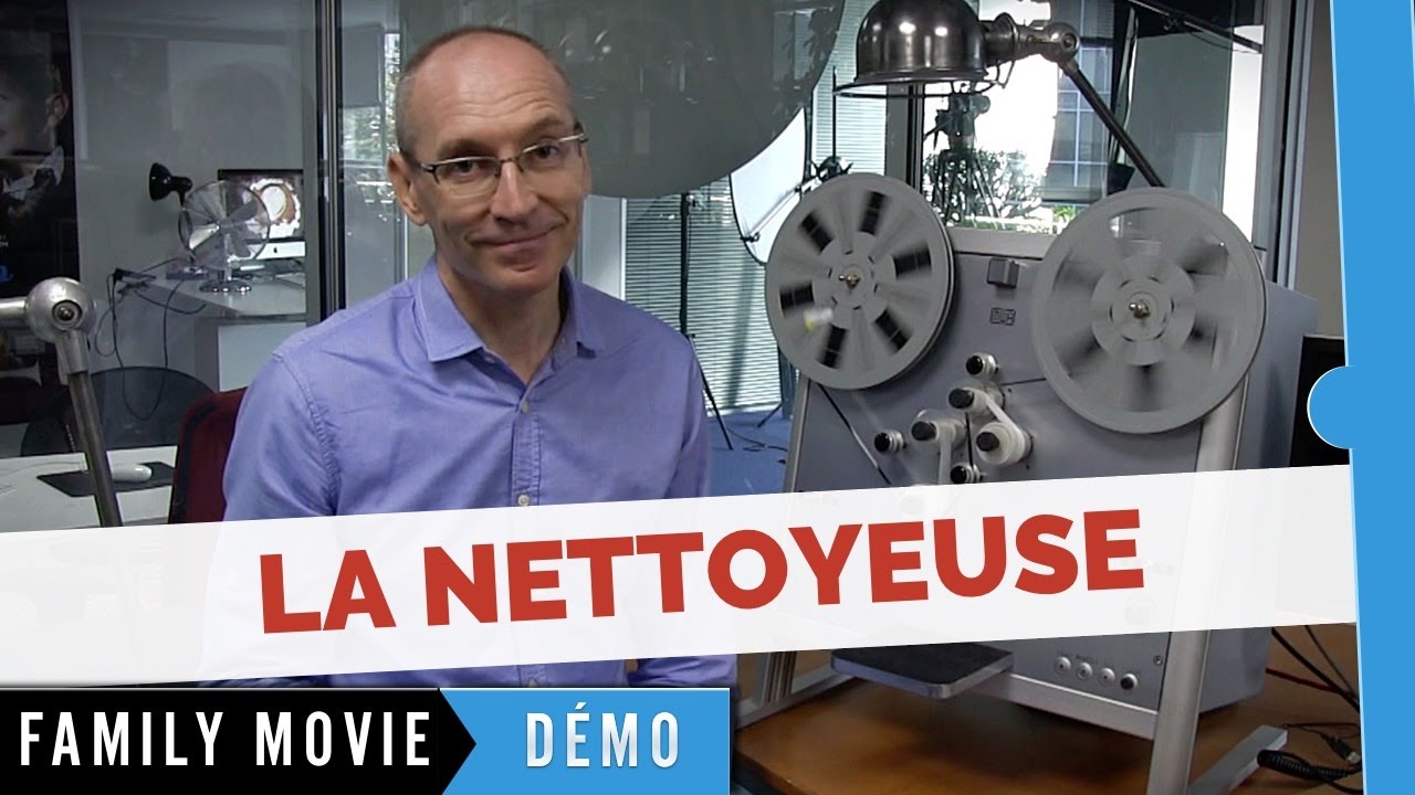

Thanks for sharing that video. I’d never seen a system like that. I’d love to see someone make those cleaning reels work on a Kinograph.

Years back MWA sold a sprocket less 16mm telecine (I believe it was only standard definition at the time), and it was common to see them at trade shows.
Cleaning spools system were then commonin videotape cleaners, at the same shows.

That video is on one of the websites @Roland linked to, I’d never seen that cleaner before either.
You and I are on the same page. I think it’d be great to see cleaning modules developed for the Kinograph. I’d envision clean-only, scan-only, or clean+scan. That’ll be a bit down-the-track though as you need the bare bones system itself functioning before people can add/develop modules for it.
