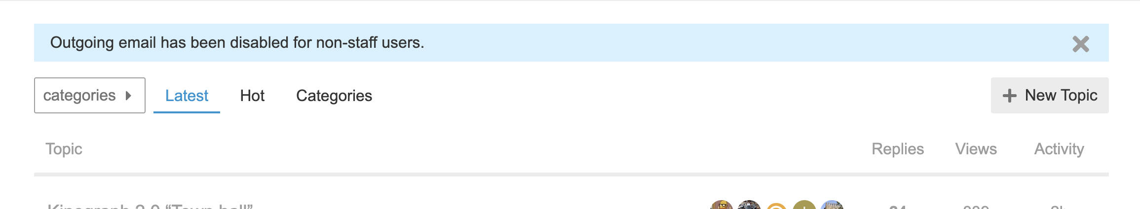

I think it might be related to this banner, which has been up for months at the top of the site:
I haven’t received updates from the forum in, well, I can’t even remember how long.

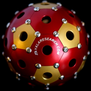

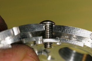

For fun, I know pictures can be fun to look at. The attached to a machined truncated icosahedra, I designed this in SoliWorks and we built a bunch of these for fun. It’s about tennis ball sized, assembled with 2-56 screws (~2 mm), there are 12 pentagonal tiles, 20 hexagonal tiles and 60 screws, with 60 custom internal retaining nuts. I think I can bring some value to the group.
Deathstar-ICON
tri-lobe4

Thanks for the screenshot! I’ll let the admin know. I’m in the process of upgrading the forums with the admin with new features and we will address this as part of that. Hopefully happening this week.
