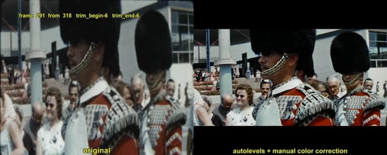

Iā€™m going to guess that within the next few years someone may well develop and OpenCV app that finds its favorite of the 24 frames and generates a composite image it likes. It may already be usable to remove spots and other artifacts during the digitization process. Iā€™ve only fiddled with OpenCV briefly but Iā€™ve already been impressed with what it is capable of for converting B+W images to color.

If youā€™re talking about using OpenCV to automate film dirt removal, thereā€™s a guy who used AviSynth to automate his dirt cleaning process as well as apply a bunch of other enhancement filters.
I also have written a fully-automated experimental film dirt removal algorithm based on neural networks.
