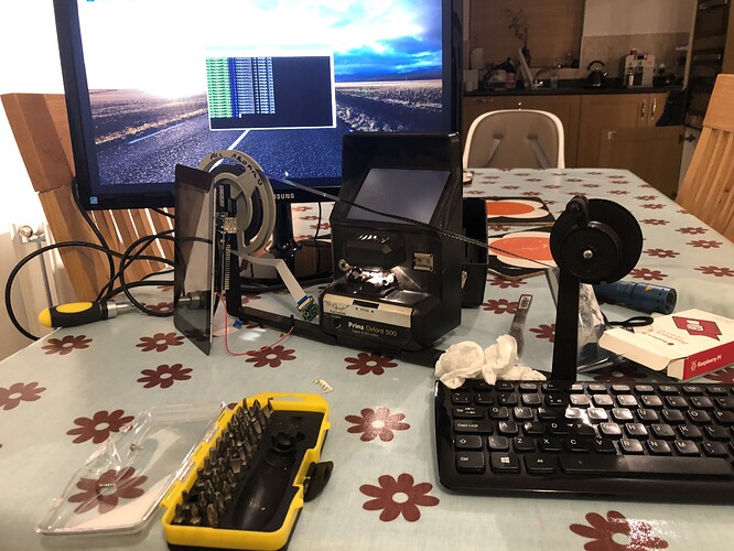

A couple of old film editing machines which I was planning to harvest rollers and arms off.

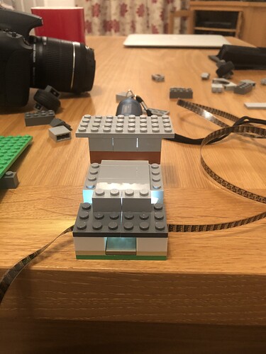

As I probably mentioned I’m aiming for a budget build. Playing with Lego, some tissue and a torch for the gate. First time I’ve seen what’s on a random test reel.

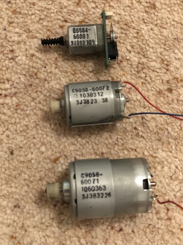

I have obtained a free printer and harvested it for parts for my budget build.
Any idea what type of motors these are?
I suppose two of these are dc motors. I do not recognise the upper one. Check this: "“how to recognize ac and dc motors.” from google.

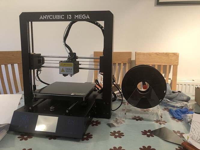

Ok budget has gone out the window. I decided to buy a 3D printer :joy:. Now to find the files for all the parts.
Woo hoo! Let the fun begin. I’ve heard good things about that style of printer.

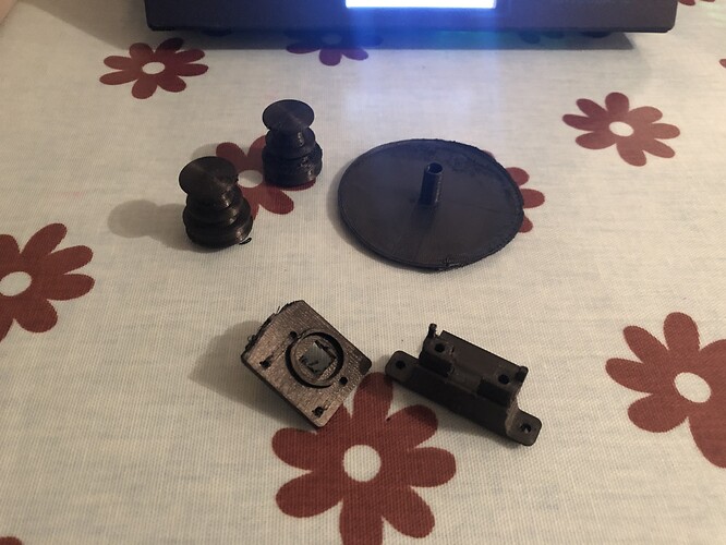

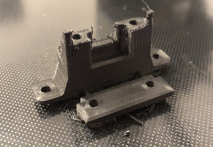

First part of the gate printed :+1:.
Getting there slowly.

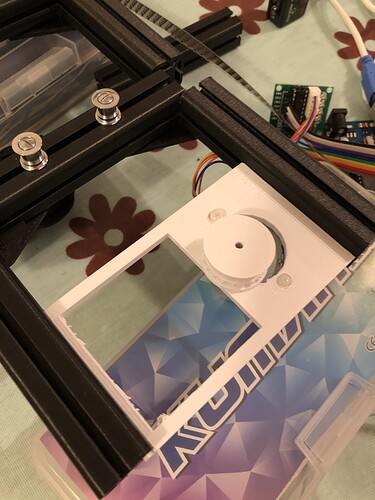

So two years on I’m digging this project out again :joy:. Let’s see how far I get this time.

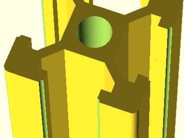

Can’t wait to see it! Looks like you’re going with RPi camera…and are those stepper motors?. And did you 3D print the 80/20 extrusion?!
Hi Matt can’t believe it’s been 2 years since I started!

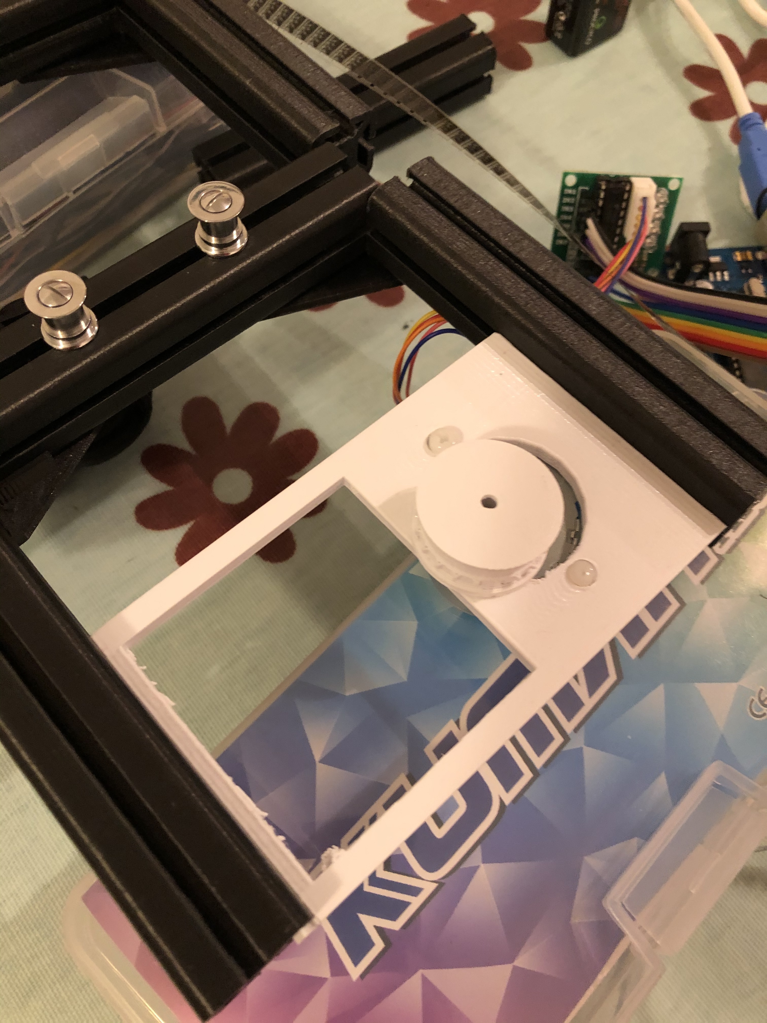

Yes they are 3D printed. STL here, I thought it would be easier to adjust/upgrade the system if the components could be slotted in.

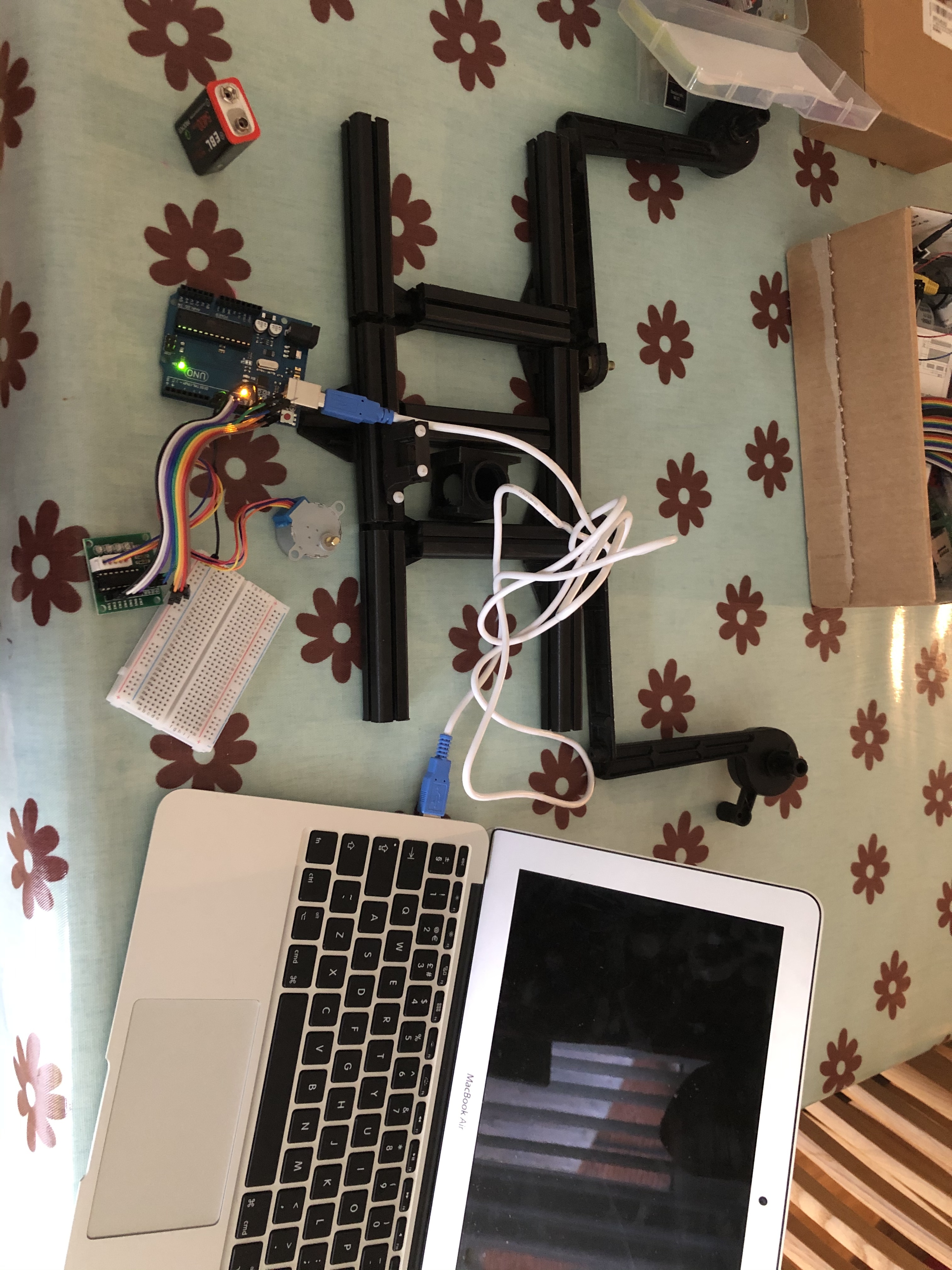

I want to keep it simple so the idea was to just use a stepper to move the film one frame at a time and take a photo with the pi cam. No idea what I’m doing but have more knowledge from other projects now so hopefully I can at least get it running.
Getting the stepper motors working this morning.

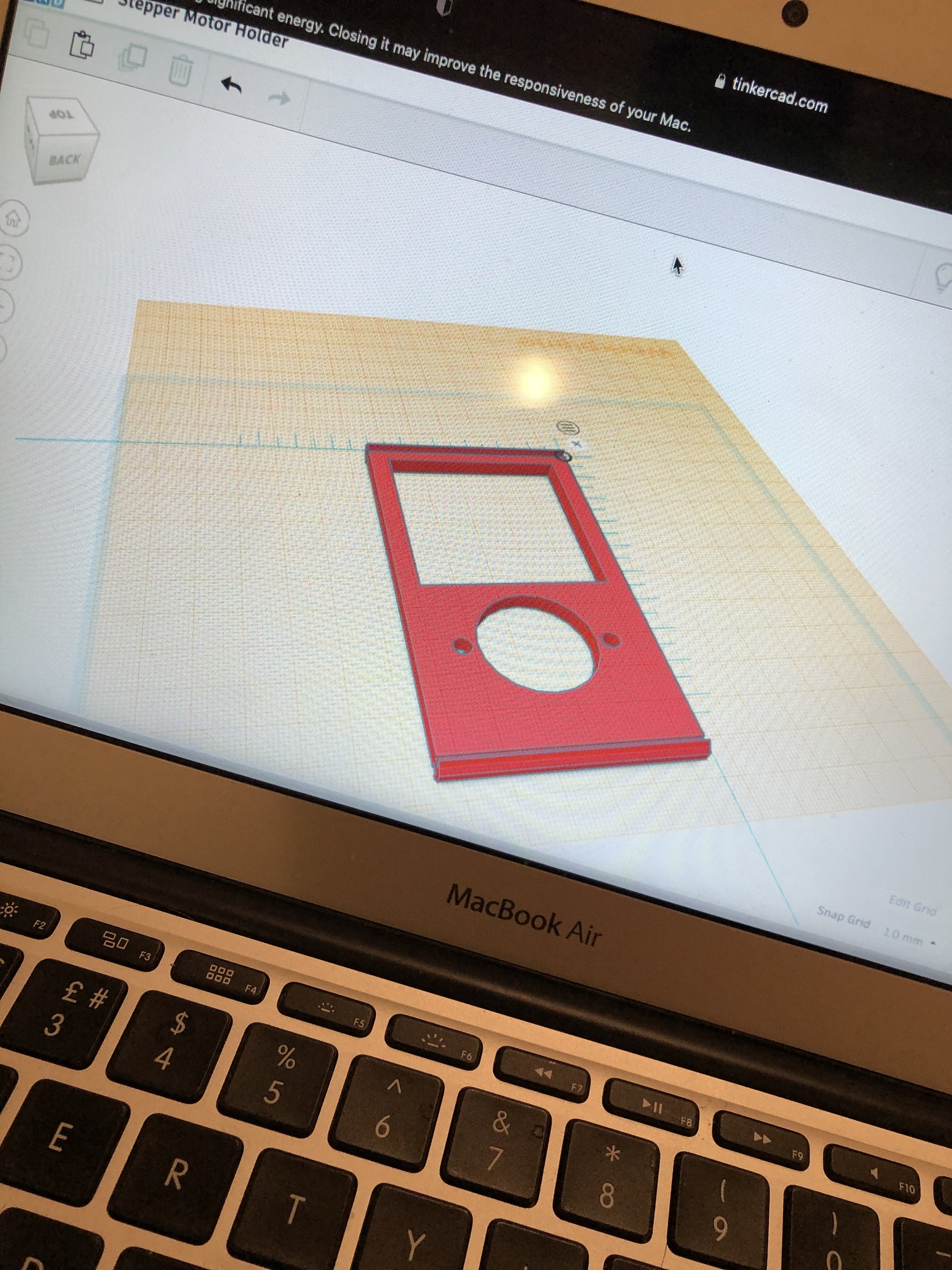

3D printed a bracket for the stepper motor. Plus a sprocket. Teeth were too big for the super 8 film though :person_facepalming:
I made this sprocket before I obtained a metal one. Worth printing to see if it works for you. Recessed to accept a bearing as well.
