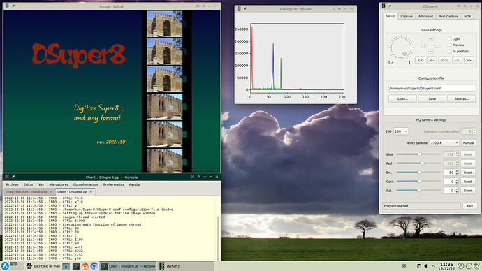

I have recently finished development of a new version (20221130) of DSuper8 scanning software.
In my opinion, the functionality and GUI were already quite complete and optimized, so they have not been changed.
Where very notable changes have been introduced is in the internal functioning of the program.
The client program has been ported to PyQt6 and Python 3.10 and the GUI functionality has been improved.
On the server the dependency on PyQt5 has been removed and the most important functions have been simplified and improved.
