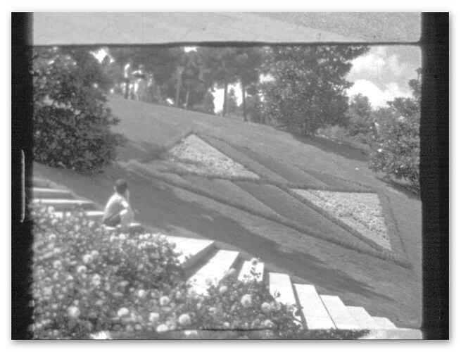

@Manuel_Angel - thanks for supplying these images from your setup! The circle of people having a little bit of noise in their captures widens! Here’s the red channel of your capture with the shadows pushed up into medium gray:
As you can see, there is a tiny bit of noise on the right side of the frame. Very similar to my captures!
Your empty film gate image shows no banding at all - that was what I was suggesting: the noise is only present in the dark areas of the image, not present in medium or high intensity ranges.

@cpixip Indeed, I must admit that my camera also generates noise bands. I had never imagined this. In fact, in normal captures they go completely unnoticed.
Thank you for your always interesting contributions.
Yes indeed. None of this is visible in the end products. I do not bother at all.
Well, the images I am attaching have been captured with the RPi5 and the HQ camera at the highest resolution.
I don’t see any banding in your in your empty gate either. But I can “uncover” the bands in your Barcelona frame border. Interesting!

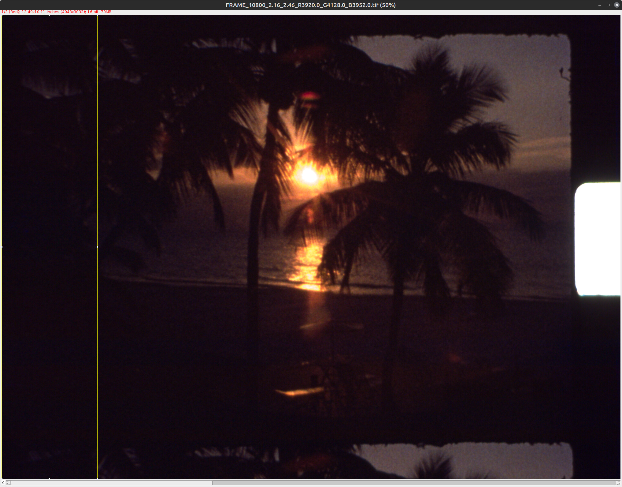

I took two scenes and treated them with color noise reduction. It was okay-ish in a scene with a road in deep shadows, but the above sunset turns out really bad. The effect needs to be so strong that it desaturates large parts of the frame, which is alright for a shadowy road, but not okay in a glowing sunset.

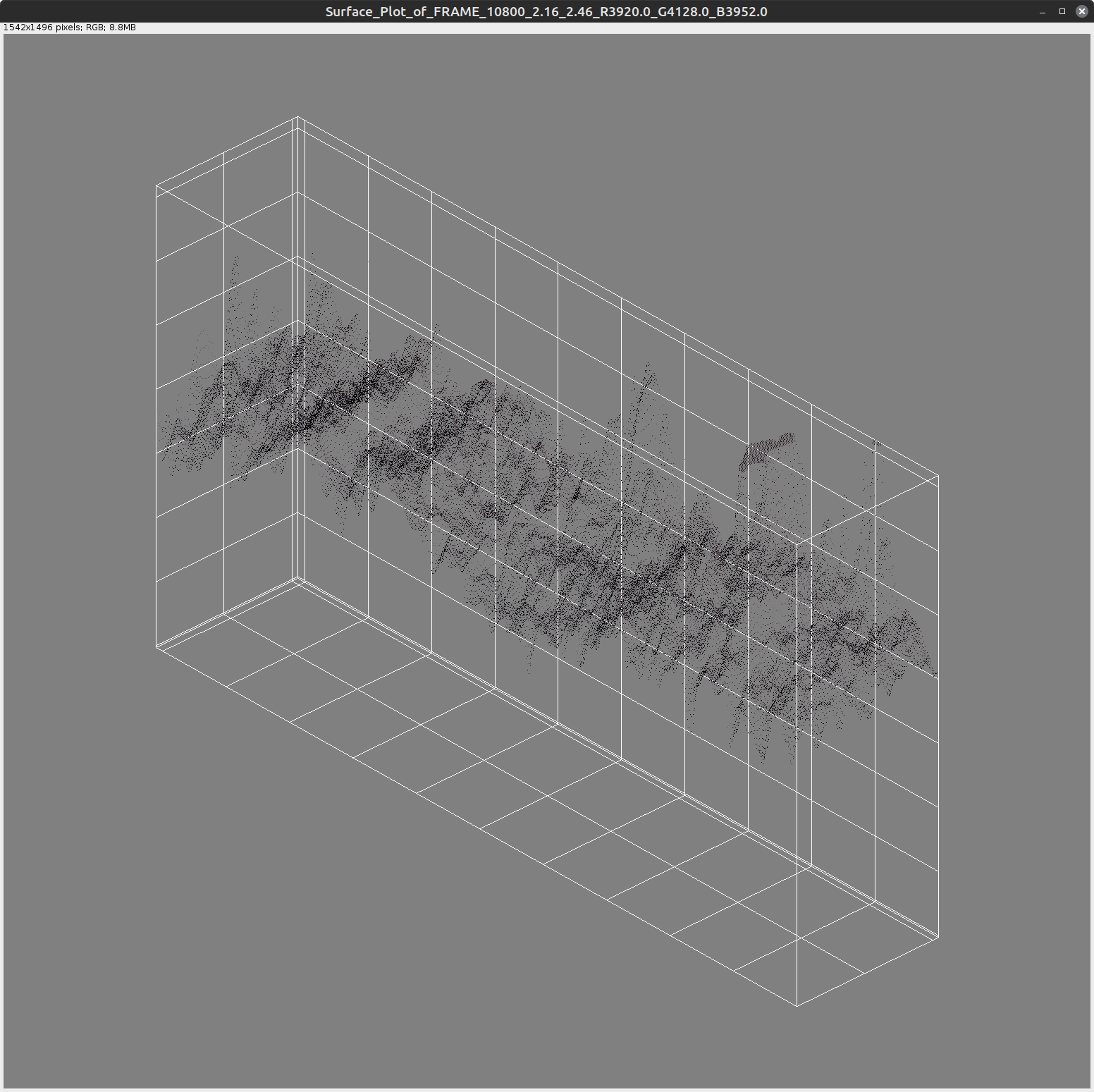

In the case of @verlakasalt, there is an additional banding from the light. Here is a visualization using imagej of this frame.
I would point out that this light-banding would also be in the film dark areas, and I would speculate that would make the clipping-banding more visible.

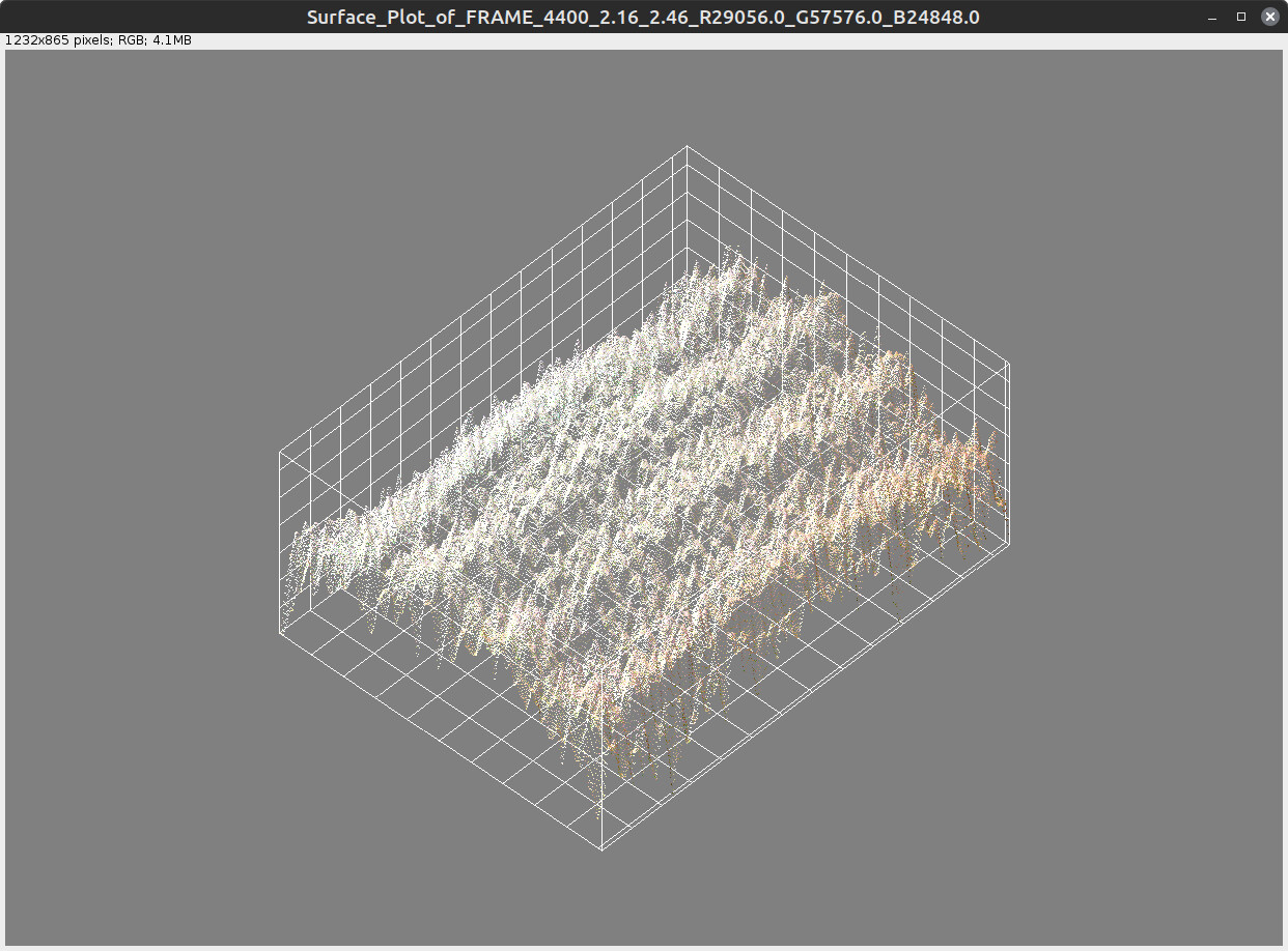

It is also worth pointing that while banding would be equally in the film dark and lid areas, it would be perceived as more intense in the dark areas.
Taking a slice of the dark left area of the beach shot (even when there is some sky)
The banding pattern can be visualized in the dark areas also.
Fixing the light would not eliminate the issues shown in the shots capped. However, I would speculate that the light is a significant contributor that is making these much worst, particularly in dark film areas which would have the worst black-clipping banding + light-induced banding.

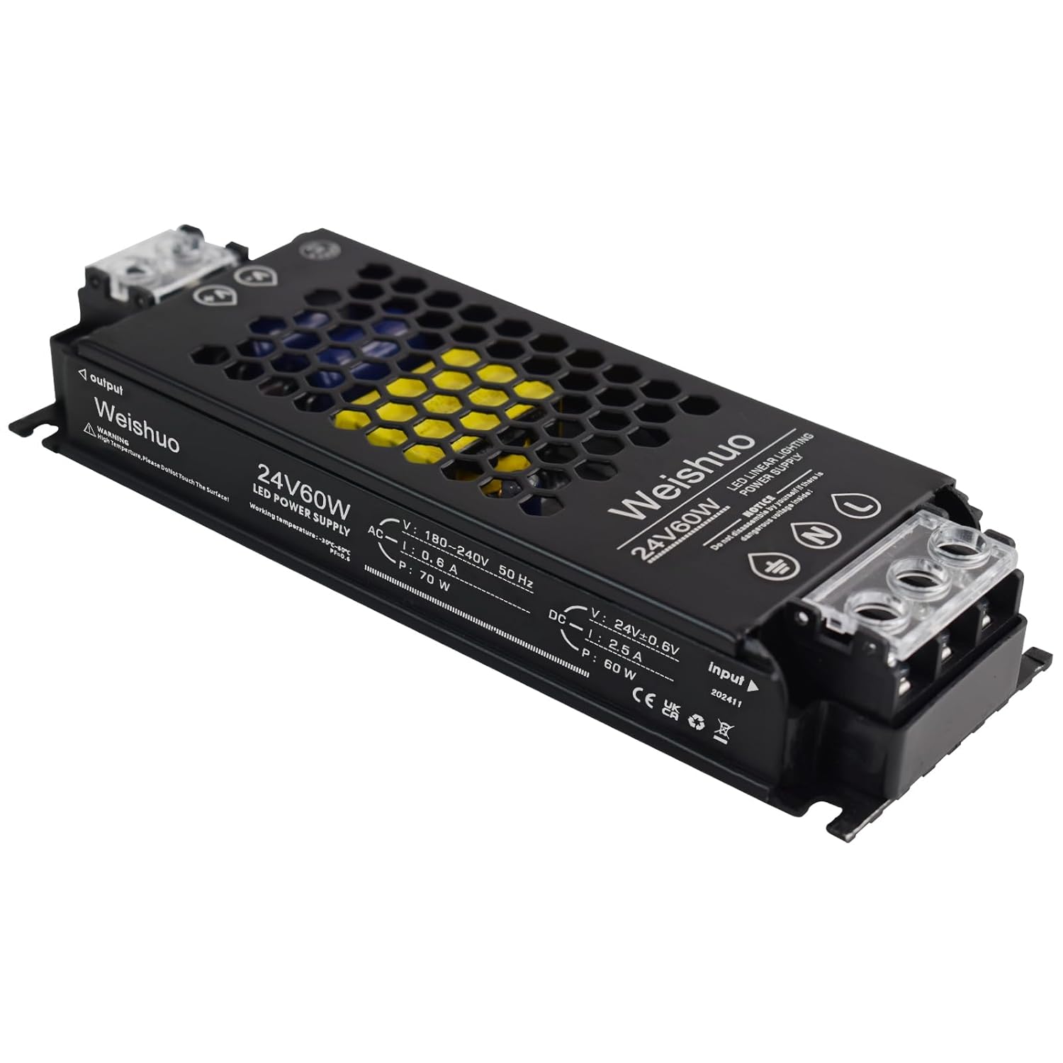

I suspect I should’ve gone with a constant current strip? Can I just use a different power source?
@Manuel_Angel How do you power your lamp?
@cpixip: I tried restarting the camera (assuming that camera.stop() is the correct command), but it didn’t change anything about the banding characteristics.
I do not see an issue with the strip.
Yes you can. If you have a multimeter, measure the output with AC Voltage, and it would give you the voltage of the ripple (typically under 1 V).
Switching power supplies don’t regulate well with light loads, and since you are only using a few lights, that may explain the increased ripple.
If you can get an old non-switching ac to dc adapter (big transformer), that may work better.
EDIT: Found something that actually says “Linear” on it.
The lamp I use in my device can be powered between 10 and 18 V.
To power my scanner (motor and lighting) I am using a 12V power supply that I salvaged from an old analog flat screen TV from 2005.
For the record: I bought this power source and banding has become less.
