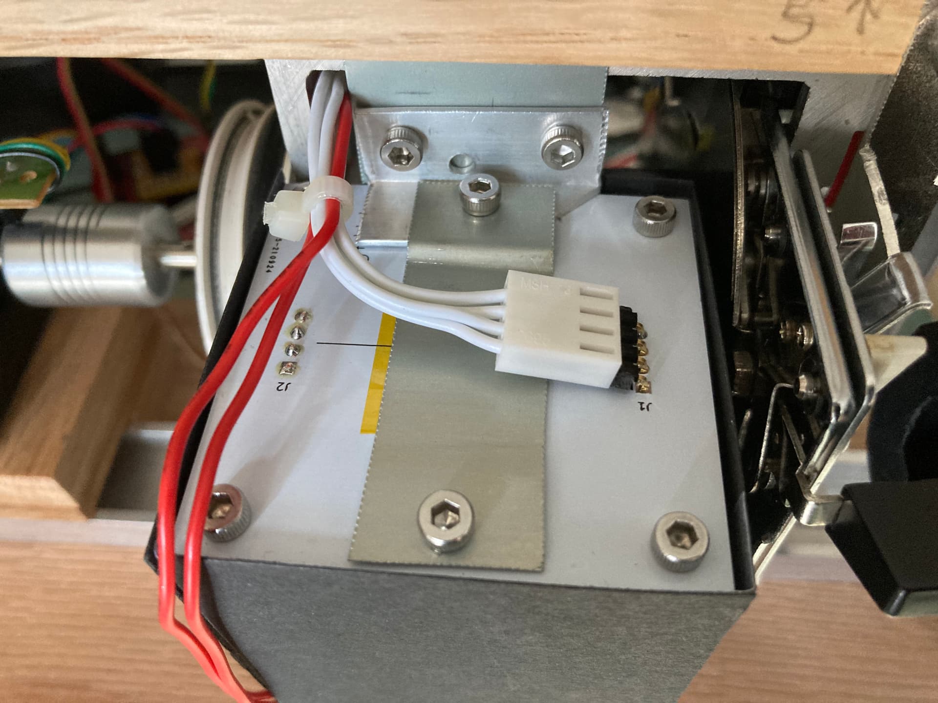

If you mean the dimensions of the lamp housing, the length measured between two and two and a half inches. I’ve included some pictures below.
The cover says 9 - 40V. What power supply are you planning to use? Steppers like good power supplies, consider a minimum of 12V. The current requirements are usually given by the specs of the stepper (NEMA17 is the form factor, check the current rating for the stepper).
