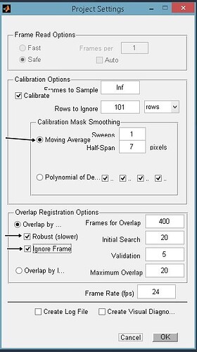

Your version is very much improved. Congratulations. Also the new version of AEO Light has many improvements. Can you share what you have done with the settings?
Udayarangi
Thanks. Really appreciate. So the difference in your sound is because of these changes. We have to learn how to get the best out of AEO, since that is the only option available.
Therefore, I asked how the settings would be correct ? To get the maximum sound quality
Dan, Where did you get that Project Settings dialogue box? I am using version 2.3.3 and could not find it.
Thanks.
I pointed - AEO-Light-Win-1.1

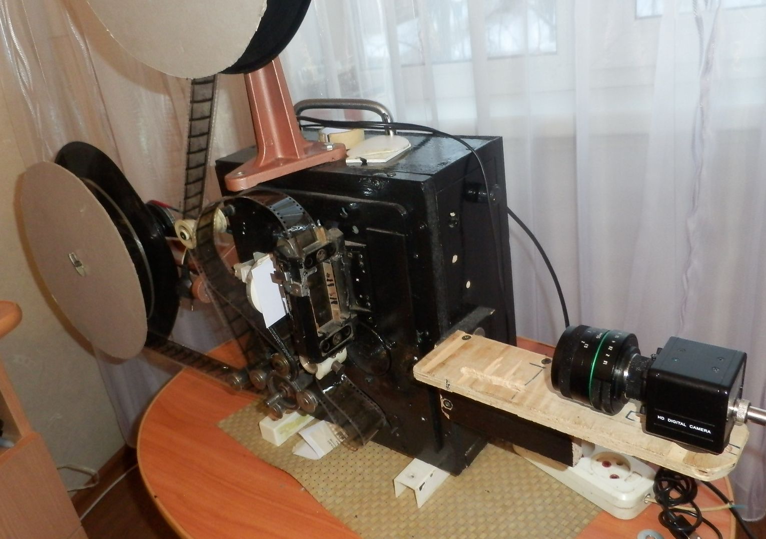

my scan setup and result
Nice. Sound you are getting from AEO (I assume) is excellent. What is the camera you are using and the resolution of the capture? Thanks.
Resolution: 2592x1944
https://aliexpress.ru/item/32831833813.html
with the lens I use two rings 5mm wide.
If I could get this kind of results from my scans I would be over the moon. Nicely done.
