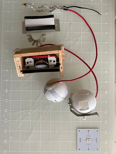

These are the White LEDs I am using (5000K), with a custom designed PCB. The LED subject and quality is a recurring theme in the forum. If the interest (and patience) is there, this may be an opportunity to collaborative design the best form factor for a PCB.
The PCB at the bottom is what I have been using with the LEDs above, first in a small oversided ping-pong ball, and now three in a 90mm metal sphere.
The SMD LED retail cost is about US 35 cents, and PCBs are not that much.
Note that these LEDs have a particularly large Vf of 9V, so typically it will require a 12V power supply (or more if connected in series). In the large sphere above I use a 32V power supply.
PS. As you can see from Manuel results, you can have good results without the complication of building the LED/PCB, so please take the above as an illustration, not a recommendation.
