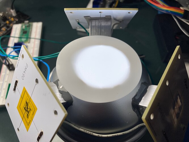

The prototype uses prior-design-existing LED PCBs, and the part of the constant-current driver previously shared. Each PCB has four LEDs, each LED is driven at about 0.7 watts. The LEDs are rated with a CRI>95, see the 5000K curve.
Plenty of light, and too much to use continuously at full power (unless baking something).
Since I had the existing LED boards, the prototype would require a connector cylinder from the sphere to the gate to avoid spilling it everywhere. The separation, makes clear that the distance between the film, and the sphere surface, has important implications: the intensity and cohesion of the light changes slightly.
Most of the spheres in the forum keep the film close to the sphere, and -if my interpretation is correct- that also provides more-diffuse less-coherent light. When the output port is separated, the same light comes out, but the cylinder somewhat narrows it, making it a bit more-coherent less-diffuse than at the surface. This is very subtle.
To illustrate, the pictures below have the same LED intensity.
Near the surface:
With a 34mm length 42mm diameter extension cylinder:
For me this was an interesting realization, yet something I should have known already: the distance from the film to the sphere surface, slightly changes the nature (diffusion) of the illuminant.

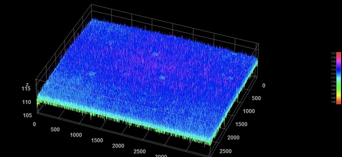

Both surface plots were performed without smoothing on the png file on the plugin of ImageJ.
One important detail of the test setup, and results: only two of the three LED boards on.
It was done to test how well the sphere is performing (and because I need to order some components to change the configuration of the driver to handled all three).
Adding the third will probably not improve the results of the surface plot or histograms, but it would reduce the exposure time.

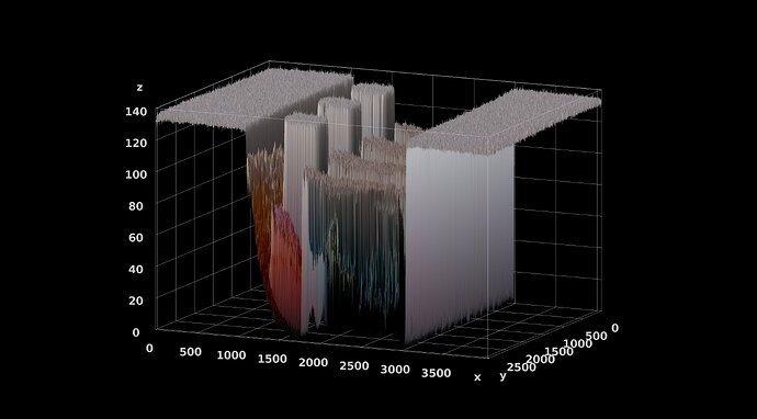

this is unedited and show some aperture-shaped dots which don’t move when moving light,rotating the lens and rotating the hq cam so i guess this must sit on the sensor? i can’t see anything on it and i’m out of ideas
The question is:
how would you rate this result and are there any improvments that can be made to remove the spots
additionaly i ran this through the Surface plot to get a better visualization
Hi @d_fens,
For your peace of mind I can tell you that the image from my sensor is almost exactly the same. A neutral medium gray practically uniform over the entire surface, but yes, with several spots.
When I bought the camera, I treated it with the utmost care to avoid the deposit of dust particles on the sensor.
I removed the cap and immediately, with the sensor facing downwards, mounted the lens with the extension tubes and adapters. I have never disassembled it again and yet the stains appeared.
I cannot upload an image for you to compare, now I am not at my usual address where I have my device.
However, I think there is no cause for concern. In real catches these undesirable spots are not noticeable.
I have similar dots. Went as far as to illuminate the sensor without lens, and these still there.
To exaggerate these, with imagej one can use the Process/Enhance Contrast, with 0% saturated pixels, and the gray picture better show the issues. In the picture you posted, it shows some of the spots are pentagons (iris of the lens), and some are significantly smaller, which could be dust spots on the sensor (or IR filter in the sensor). Using the enhance contrast will also show any slight deviations of the white balance. Recommend you save the image in a format without compression, otherwise you will see a lot of the compression artifacts when doing the enhancement.
In the images above, I also set denoise to off, reason why the noise may seem a bit higher.
The surface plot looks flat, if that is with the lens at the focus distance, you have great results. Try the enhance and see if it will give you additional clues to chase the spots.

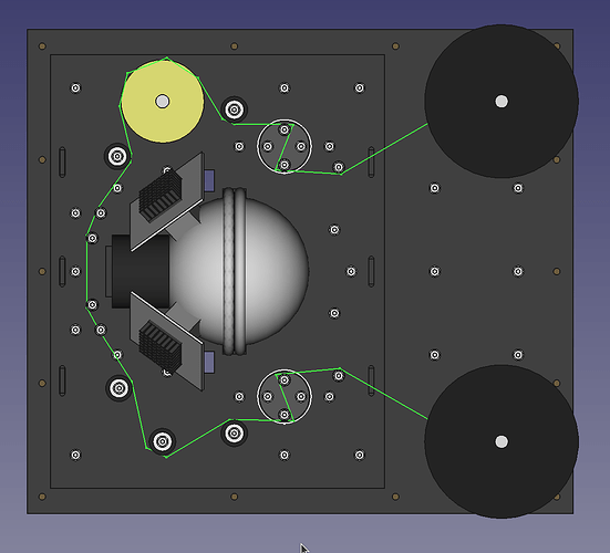

The new transport will test a U-Capstan, where the film is pressed to the capstan by tension, instead of another roller pressure directly. This part is yet untested, it will be assembled with the laser-cut plates. Here how that portion looks.
The silicone roller (yellow) is driven directly by a geared stepper motor, the two reels are also mounted on the axis of geared stepper motors. I found a silicone wheel that is 10 mm height and 50 mm diameter, so the precision is there to move the film very accurately, as long as the film holds to the roller (the testing part). The Zs in the path are the tension potentiometers, when the film is in tension there will be no Zs in the path. The bottom reel is the supply, the top reel is the pickup.
The capstan will increase the tension at the supply side, and decrease the tension on the pickup side.
The tension sensors on either side will provide the feedback/control to unroll the supply side to hold the tension from increasing, and roll the pickup side to hold the tension from decreasing.

This change was done to minimize the area of the PCBs, now opting to stack the Drivers with the DAC board as bus/backplane.
A nice byproduct is that it would make the DAC and Drivers virtually stand alone to work with other controllers with an I2C master, like other development boards, or the RPi.
The Pico will stay with the stepper drivers, and will now have a I2C connector to drive the stand alone DAC/Driver block.
