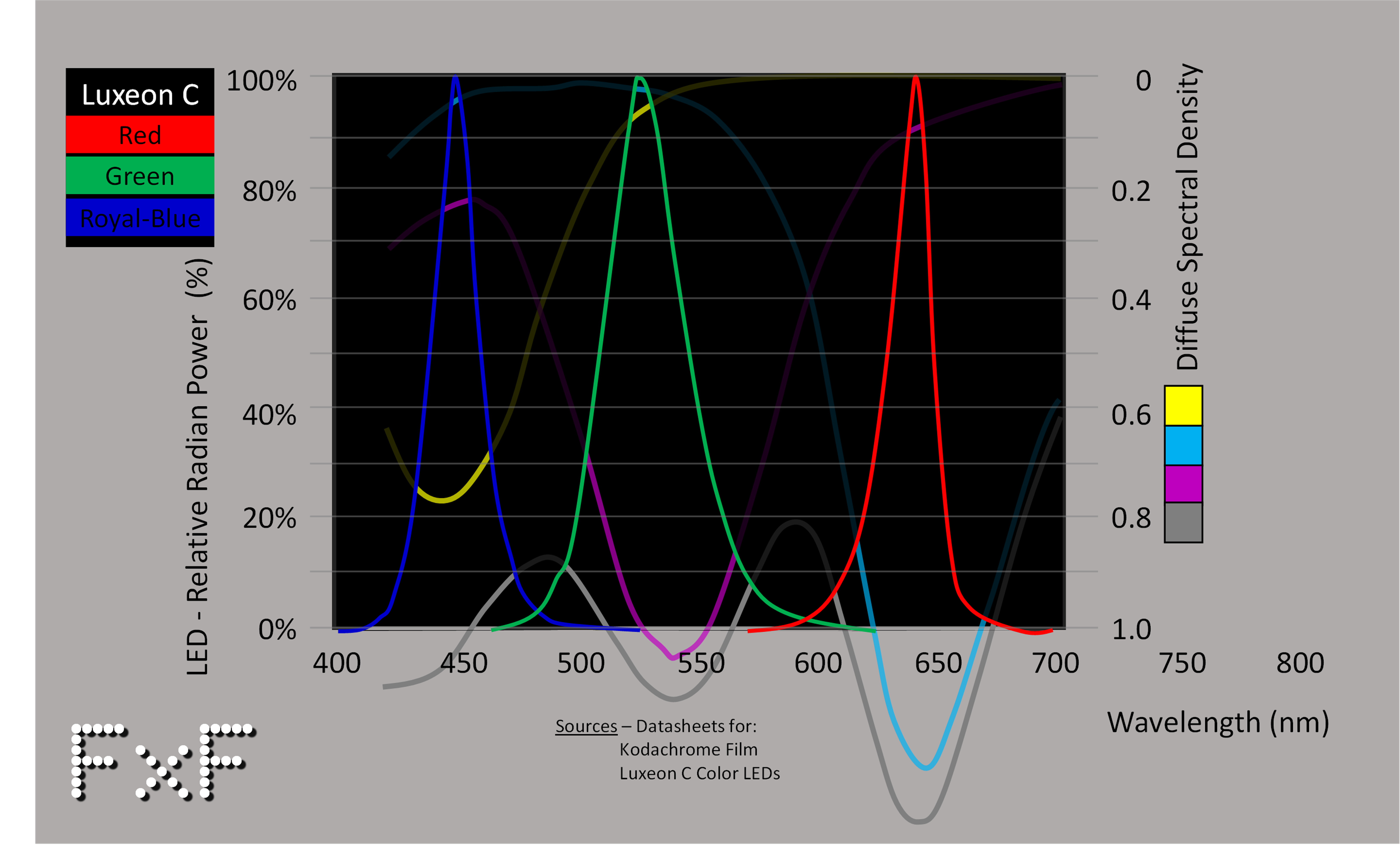

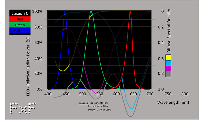

@dawsmart After additional thought, I would like to clarify the above, since RGB has some considerations too.
Most RGB only setups would have the limitation of acting like narrow-band filters, with -I think- the undesirable result of limiting/narrowing the scanned colors. In other words, colors that falls outside the LED wavelength would become invisible or attenuated to the sensor.

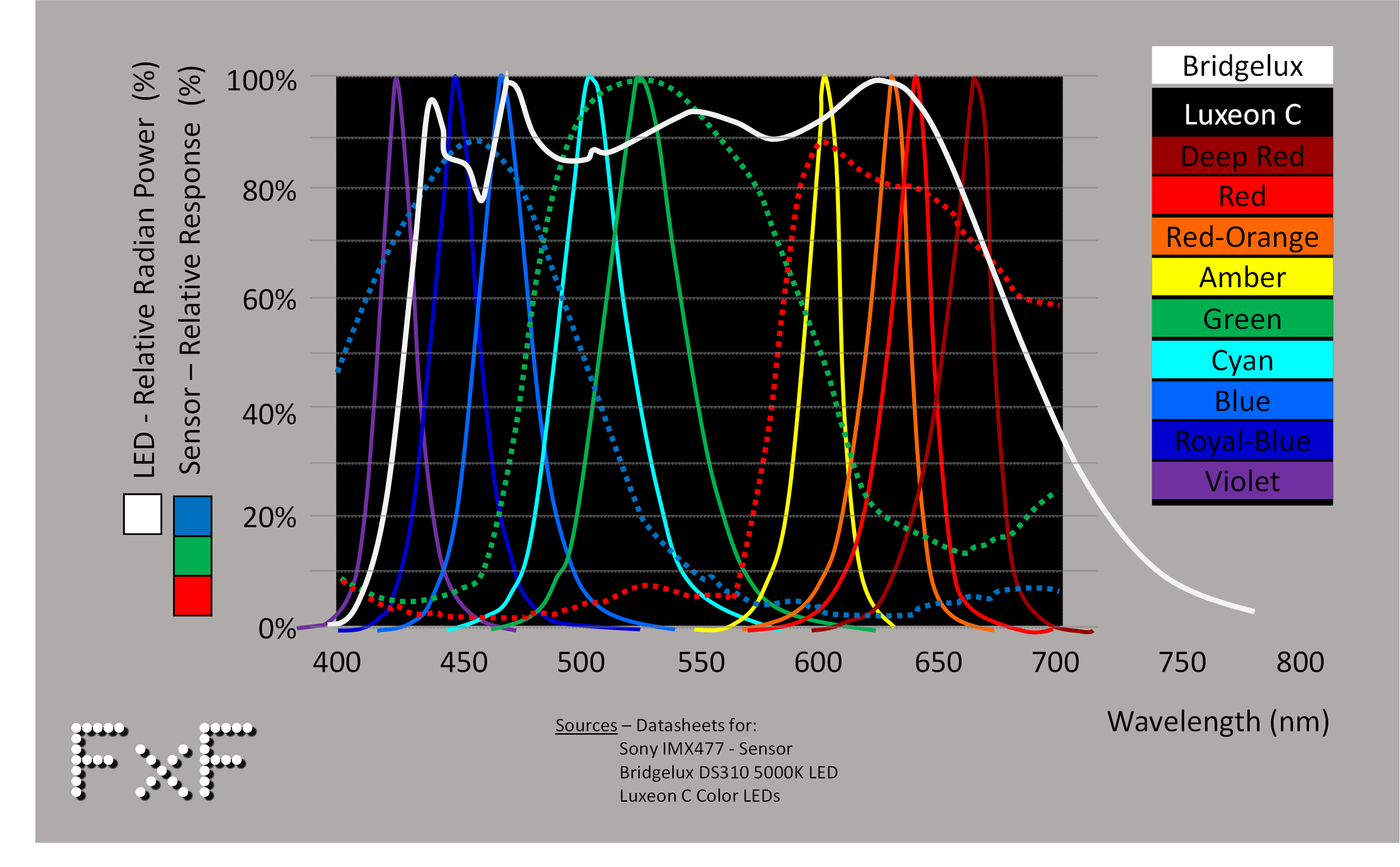

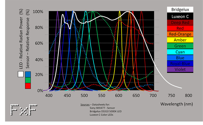

Below an illustration of the problem. A very visible part of the Green-to-Red would be invisible even if using all 9 color bands.
One can see how narrow is a single R or B or G color LED in relationship to the sensor color band. The illustration also showed me how good the present white LED light source is (at the expense of living with the phosphor response times).
@cpixip Rolf, since light physics is not my strength, would love to crosscheck this with you.
A common problem with old films is, of course, the red fade that occurs, but I know that there are ways to recover some “lost” colours by post-processing. It would seem to me that these LED lighting setups will be critical to ensuring that all the subtlest colour information recorded on those weary old film frames is translated to digital data such that the “true” original colours may be one day resurrected.
When it comes to cost, in my case, I would be willing to pay more if necessary for a backlight with minimal attenuation and filtering of light waves to maximize whatever colour detail could be captured. I suppose I feel the same way about HDR capture. For some films or film segments I would go the extra mile to squeeze every bit possible - whatever it takes to get that level of quality would be worth it.
Most likely though with any motion picture scanner build one could dial down the quality when it is not required, such as when speed and quantity is more important for certain films.
@ PM490: - fantastic overview you created there!
Indeed, a single LED acts (as illumination source) like a bandpass filter. This is somewhat undesirable, as the range of wavelengths sampled might just end up in a valley where there is no good filtering from the dyes used in the film. However, from the data sheet you once posted for Kodachrome, it seems that the dyes have a rather broad spectrum.
There will also be an interaction between the camera’s filter and the LED’s curve. For example, one should expect very different red tones in the scan if switching the “Red” LED to the “Deep Red” LED in your graph.
Imagine for a second how film stock was viewed in the old days. In a usual Super-8 scanner, typically a halogen lamp was used. The spectrum of such a lamp corresponds rather closely to the spectrum of a black-body shown nicely here in this Wikipedia-animation:

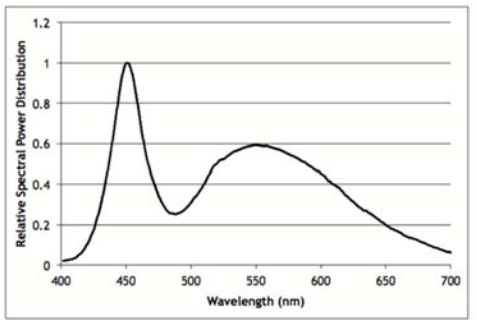

Clearly, the Bridgelux LED comes much closer to the spectrum of a black body radiator than the sampling composed of three individual color LEDs.

The following illustration is a good summary representation of the trade off of RGB only LEDs.
I dimmed the die curves outside the LED spectrum, which I think would be attenuated or not captured by an RGB or Monochrome sensor if using RGB only LED.

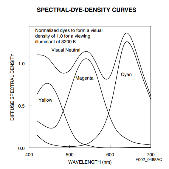

If you are working with standard film stock, there are for example IT8 targets and software available which do a decent job in making sure that the colors you have in your film stock are properly transferred into the digital domain. But even than, most digital displays fall rather short of the dynamical range classical film stock paired with an old projection device is able to deliver. But that’s another story.
But, what do you do if you have another film stock to scan, quite possibly one out of production for a long time, like Agfa Moviechrome? Your IT8-calibration with the currently available film stock might get you close, but you do not know how close. For sure, there is no way to manufacture a IT8 calibration target for that old film stock.

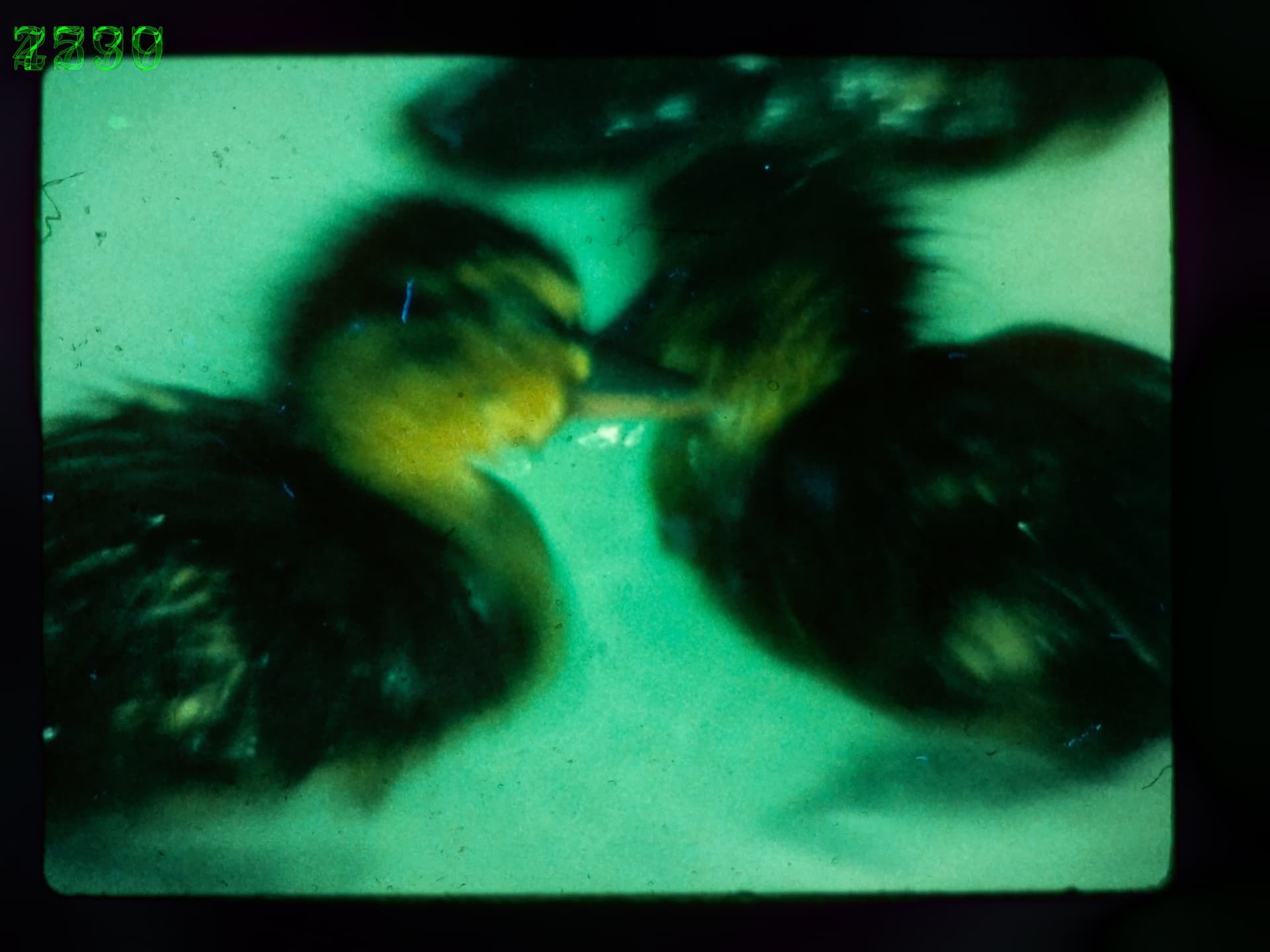

This is how the film stock would appear to you when placed on a perfectly white background (which gives your brain the “white” reference).
However, when the original footage is projected in a dark room, things change dramatically. Missing the white background reference, your brain is going to adjust your color perception. The projected image as perceived by the viewers would look more like this:
The issue here is especially present in Super-8 film stock, as the cameras had only two color temperatures to work with; the film stock was fixed at tungsten 3400 K type A (indoor use), and you normally worked with the build-in “daylight” filter outdoors. In many situations however (like the one discribed above) the illumination situation was more complex, creating color cast. They are easily noticable in the digitized versions, but were much less noticable in any projection setting.
The second example is connected to the small length of a typical Super-8 reel, featuring only 15 m of film stock (a few minutes of film). So you typically worked with serval different rolls in single movie project.
Occationally, the final rolls got developed differently, so color shifts are noticable between them. Here’s an example. This frame with decent colors
is followed a few seconds later in the movie with footage that looks like this:
The color difference is due to the fact that this footage comes from from another roll of film, obviously developed somehow differently than the previous one.
Note again here, the greenish tint in the later footage would probably not be noticed by the viewer in a darkened projection environment; the brain would “white-balance” the difference out. But the difference is there and noticable in the digital version.

One step back is probably using a white-light LED. Nowadays, the quality of the top-level LEDs have remarkably increased. But if you look at the spectral distribution of the Kinetta white-light LED, as listed in the paper above,
grafik
you notice two prominent peaks. The narrow one, at the blue end of the spectrum, is actually the peak of the blue LED used in these white-light LEDs; the other, much broader peak is due to fluorescent dyes. Together, they trick the human visual system in seeing that light as “white”. But the interaction between such a spectral distribution and the camera’s filter characteristics could be stranger. Nonetheless, newer white-light LEDs have a better spectral curve, and it’s probably a feasible option.

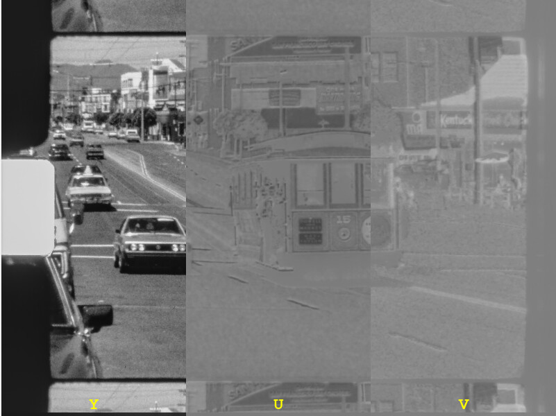

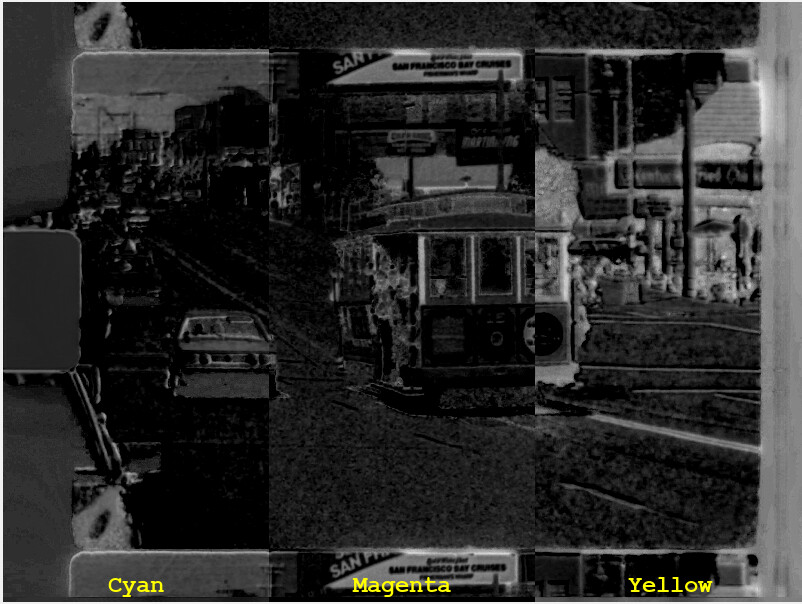

Hmm - if I understand this correctly, you want to scan each frame in three passes, a full spectrum (“white”) capture, plus a red and a blue one? And then combine these into appropriate color channels? Interesting idea. In principle, that should be equivalent to scanning red, green and blue, at least as long as you are staying in the linear domain (i.e. raw images). Not sure about noise levels and quantization issues (dynamical range). But frankly, I do not see any immediate advantage of such an approach, as at that level, you are working in linear space and can transform this new approach into the standard approach working with RGB-filters by a simple transformation. As you mentioned, nearly every camera does that sort of transformation (RGB->YUV) . JJust for fun, here’s how one of the frames posted above will look like in YUV:
It is clear that the dynamical range of the U and V channels are lower that the Y channel, which is more or less equivalent to the brightness of the image (that is the one of the reasons why YUV is used in video applications - saves space). Just to throw another thought into the discussion: actually, the film layers are cyan, magenta and yellow layers, so we are actually trying to digitize something like this here:
Presumably, one could sample that stuff directly with appropriate placed LED curves and a monochrome camera? This is indeed somewhat discussed in the article linked above, ff. 14, but the unsolved question remains: how to get from such an optimized color separation process to a faithful color rendering process?
Yes.
Yes
The capture with white LED will have all the spectrum that is being filtered/discarded with a narrow RGB Led.
Y is an arithmetic combination of RGB, and Y full spectrum - unfiltered- is captured.
The trade-off is the capture of Blue and Red, which would be narrowed by the color LED band.

Well, let’s consider first the maximum possible information in terms of color. That is actually possible, namely by using a spectrometer - which would yield hundreds of numbers for each image spot. A little below that quality are hyper-spectral cameras, which yield at least data in several different wavelength bands. Citing again the paper by Flückinger et. al.,
grafik
Actually, such approaches have been used in the past to scan important artworks, and the multi-spectral data is usually sufficient to “illuminate” the scan in arbitrary illuminations, for example in VR-applications. For film scanning, the time required to aquire a full spectrum is prohibitive. And it is even not necessary, as the spectral information is anyway condensed in the human visual system into three numbers per image spot.

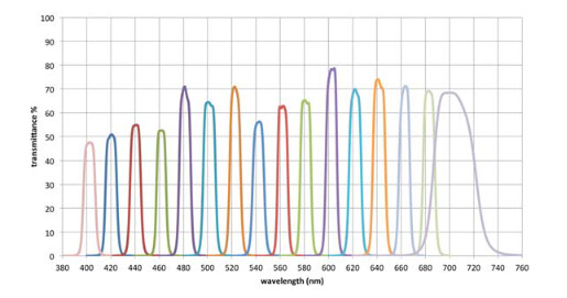

If time and storage is not an issue, one could achieve something similar for film with a monochrome sensor and multiple exposures of more narrow band LEDs. But on the human eye, all that would become 3 numbers as you point out.
If that is done, one would be able to blend these to effectively widen the resulting bandwidth of each RGB by blending only those that match the wavelength for the channel. Not sure it is worth the time and storage.

The Ektachrome post is 12 bit raw with white LED.
The film no longer is capable of faithfully reproducing the scene colors. When increasing channel gain in color correction, one should try to have a source with sufficient range to avoid digital artifacts/noise resulting from a limited range capture.
In this cases would white, or a tri-pass of Y-B-R would be a better source image than narrow band RGB? I think the answer is yes. And by source image I mean one that requires processing/correction to render a faithful scene.
